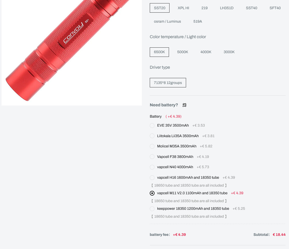

I just discovered something cool when scrolling the shop - we can now select 18350 batteries when ordering 18650 lights that have tubes available, and Simon will automatically swap the tube. No more need to order separately. Also, thanks for adding the M11 v2.0, Simon!
This is great news for a 18350 fan like me :wink:

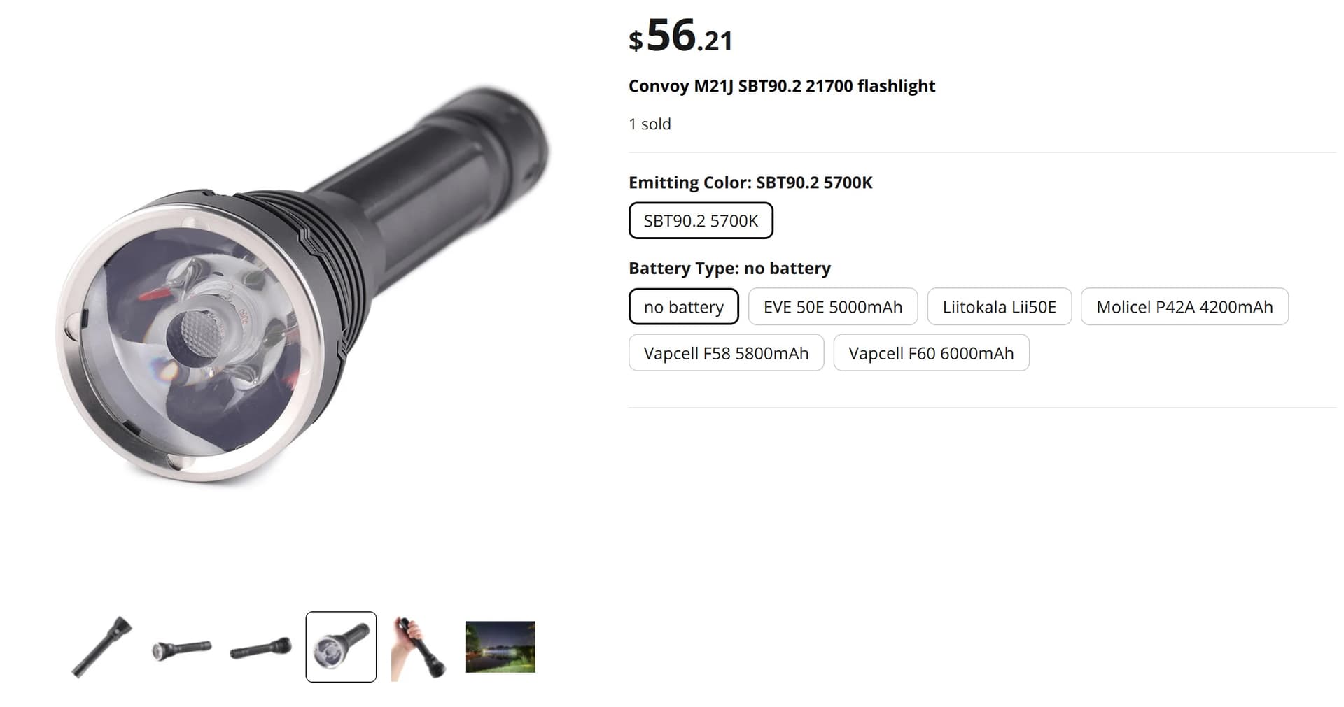

I just saw the M21J pop up. It’s intriguing.
I wonder if there will ever be a 2 X 26650 and/or 2 X 26800 version of it (like the L6 and L7.)
7 Thanks
Any advice on the battery choice?
From the product description:“Battery type required: 2*21700 batteries (can bear 10A current)”
Vapcell F60 6000mAh seems like a good choice as they supply plenty of amps (12.5A) an have the highest capacity. Would there be any advantage (brighter light) by choosing Molicell P42A 4200mAh?
The advantage would be capacity/runtime, if you bought something like the Samsung 50S (5000mAh) or Molicel P45B (4500 mAh) to put in it.
This light uses a 20.5A buck driver rather than a linear driver, so as long as the light is getting 10.25A from each cell, it will be at max brightness. Putting in batteries capable of higher current won’t increase brightness, although depending on the cell, it may shorten runtime due to lower capacity.
So if I understand correctly the longest runtime would be with Vapcell F60 and other batteries with higher current (50s/P45B) would not change the brightness but only lower the runtime, correct?
Correct.
