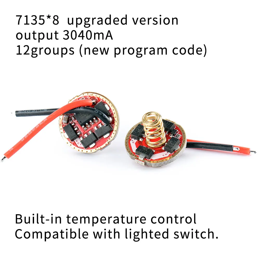

Your S2+ comes with old driver. Not bad because at the moment with the new driver I can’t enter to config mode, with 10 or 20 clicks always change to next mode.
Solved. The new driver needs to tap more fast than the old to enter the config mode.
You bought and soldered the new driver, or got Simon to build an S2+ for your?
It’s a 219b 3500k custom builded from Simon. Silver with rubber button and OP reflector. I use the lighted switch from another S2+ that didn’t work well with old Biscotti driver.
This is the new driver:
So Simon added the new driver for you?

It’s also available on this driver (12 group) and tried it but like i said, 50% is perfect but then i don’t have 100% when i choose that group :-(
Yeah, it’s bit annoying sometimes. I have run in that same problem, when 20 isn’t quite enough but 100% is overkill. I also use 3 modes on my work lamps.

No suitable lens for H1 currently
Sorry, I found that the old 7135*8 driver is still installed in some flashlights. Please PM me and tell me your address, and I will send you the new driver
