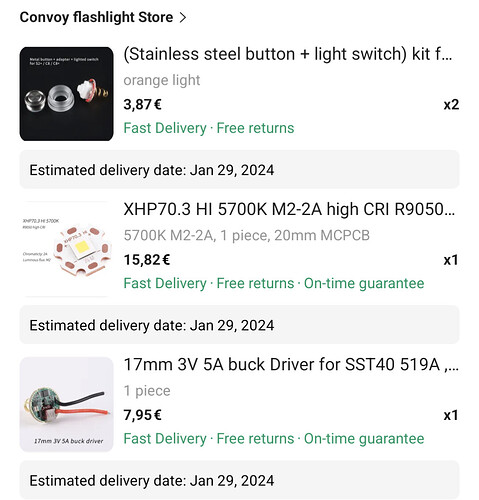

EU people always get new aliexpress listings a few days late, Aliexpress needs to run them through import checks for VAT and stuff. Guess UK is the same.
Does not work for me (Italy) either. Usually after a few days those links work.
Simon, I was told you are selling 5700K 90CRI XHP 70.3 HI but can not find them on the shop - are they not yet visible for EU, or am I searching wrongly?
Link to the 5700K 90CRI XHP70.3. I can’t say if it’ll show up for you in the EU though as I am in the USA.
Thank you! Yup, it’s dead for me. Looks like I gotta wait.

They got online now for EU customers - ordered already.

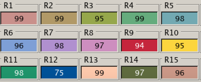

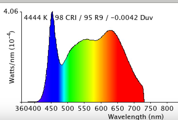

Moonlight, B35AM
CleanShot 2024-01-09 at 18.35.41@2x

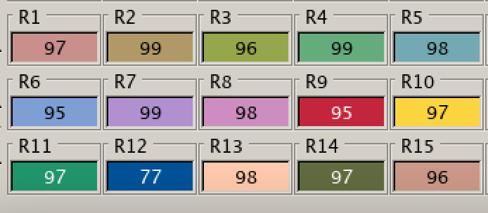

Med
CleanShot 2024-01-09 at 18.36.57@2x

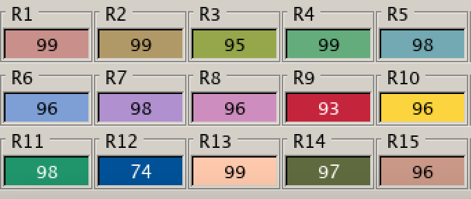

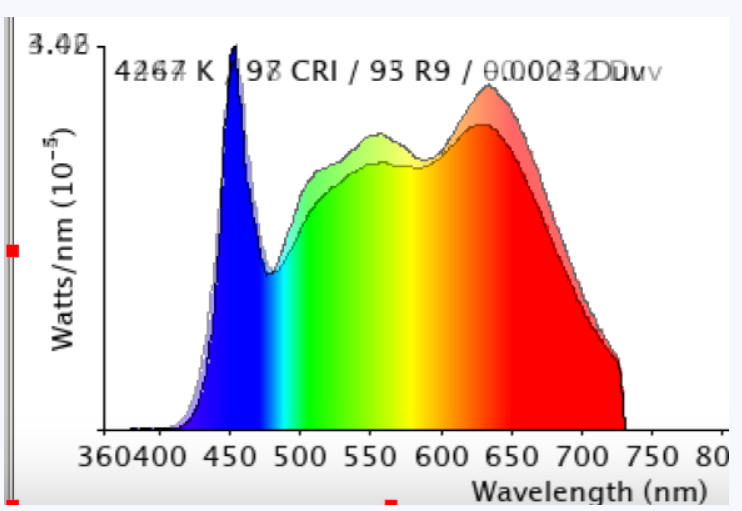

Turbo
More blue & higher CCT on higher currents but no significant changes in CRI on 4500K B35AM driven at up to 2.4A (I believe, S21E).
Perhaps the observation of CRI always lowering does not apply to B35AM. On the other hand, zeroair’s review of the S21D observes a CRI drop from 98 to 95!
I made a quick overlay of your moonlight/turbo plots–thank you for providing them. Once the spectral distribution is normalized, gaining too much blue is equivalent to losing red and green!
