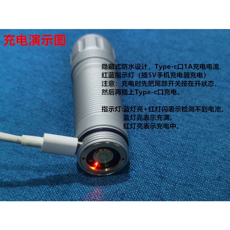

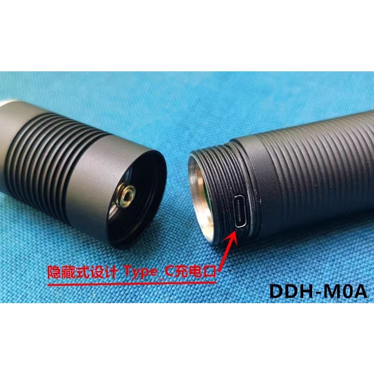

Hi Simon,
What do you think of this. Do you have any plan to make “hidden” charging port model? I found out about this brand “DongDongHai” on Taoboa - they make budget hosts with integrated USB-C charging hidden in the threads.
I know some people are concerned that the rubber flap maybe is not sufficient waterproofing for heavy water - or some people don’t like the look of external charging port. I think this could be an interesting option, and I quite like the idea.
Looking at the 2nd pic, the charging module is placed on the end of the tube so it is sandwiched between the driver and the battery. But then, it looks like battery can only be loaded from below.
Of course, this will probably mean that overall length is longer than usual. Unless it is made with TIR optic based shorter flashlight.
That looks like the Jaxman E2 host, interesting.
