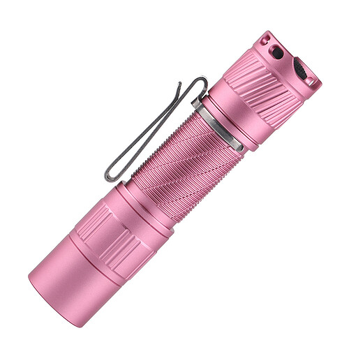

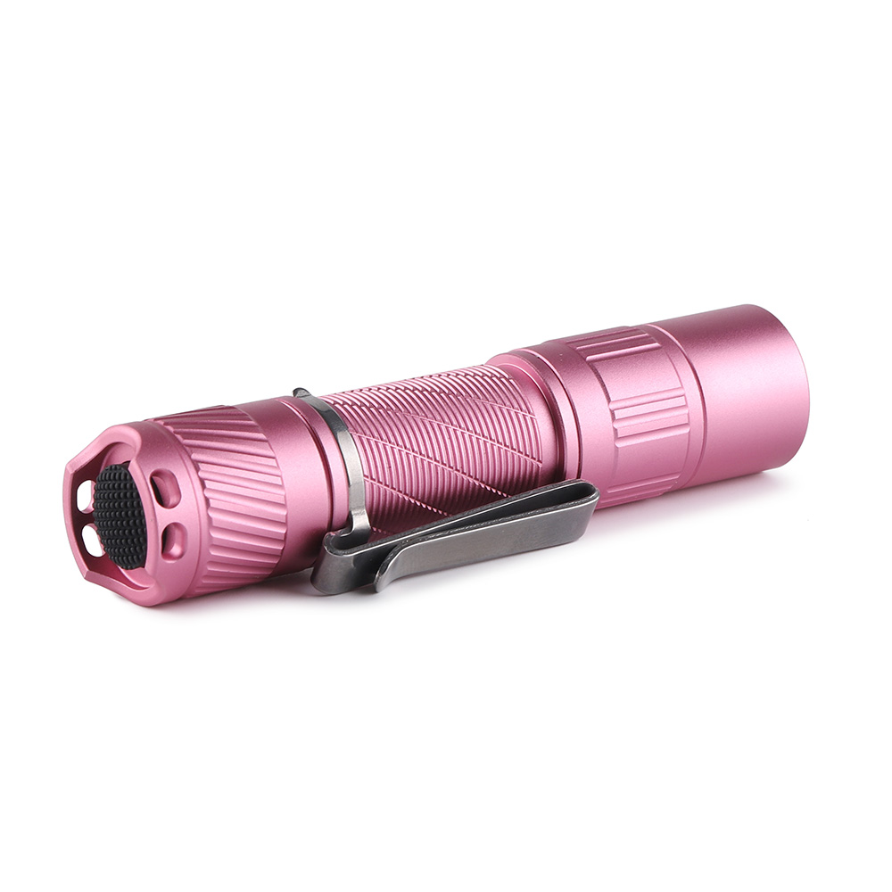

Is this a T3 with a slimmer battery tube? Are the tubes interchangeable with the old models or are there more changes to the light?

Love the new pink! Also didn’t notice it is a slimmer tube design. I noticed the new double sided clip doesn’t quite meet the slimmer tube body. Is this the new norm?

This update will be made in future production batches for all T3.
The weight will be lighter.
This only applies to the 3535 led.
There will be some slight deformation of individual clips.
Some clips will be close to the tube, and some will have gaps.

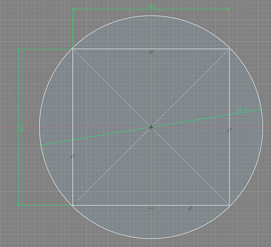

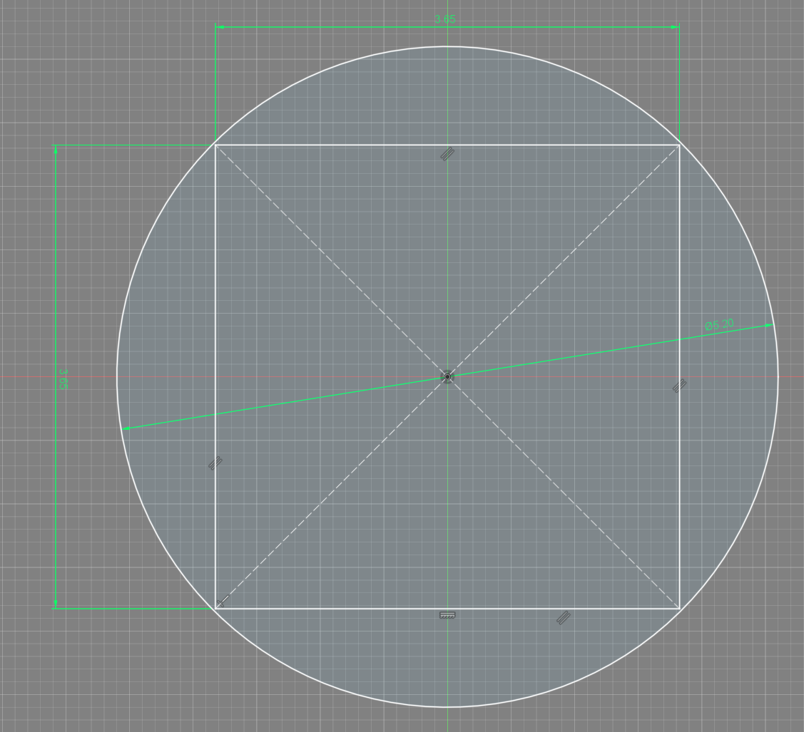

I asked since, based on specs alone (5.2mm diameter of the hole) the 3.65 x 3.65mm B35AM should (just barely) fit this TIR. I still plan buying a second S21E with a B35AM, so this would be very interesting if it works.
Wow, you don’t have any tolerances at the corners of the LED… it would just about fit, but the position of the board and the LED must also be right.
I actually prefer the current tube diameter.
How much lighter is the new T3? The description says 47g for both pink and orange flashlights, I think it needs to be corrected for the pink one.

Yeah… I mean, the MCPCB can move on the past unless screwed down, so it should be able to center nicely.
If the LED actually fits (I take the specs with some caution) I will 100% try this combo.
You are correct.
It is suitable for B35AM ,too
