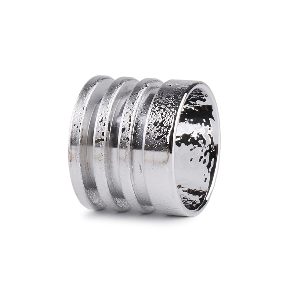

Hi guys, got a question. I really like the designs of both the T6 and T8 but I much prefer TIRs to reflectors (so much so, that I don’t have a single reflector light apart from the Sofirn Q8+ and the FFLite L70, I even swapped a TIR into my TS22, much prefer it that way and would swap the L70 as well if I found a matching optics). With that in mind, are there any TIRs that would fit the lights in question? Or at least what are the dimensions of the reflectors? Maybe I’ll manage to find something that is close enough and can be modded to fit.
T6 reflector you can find here and see the dimensions. T8 no idea.
There were no dimensions in the product description (correction, it’s given as Height:20MM Width:21MM, but seems it’s a bit off compared to below review) but someone did measure it in the reviews:
Mści*********wski
Its exactly 20.5 mm height and 19.08 mm (my edit: dimensions switched)
Additional question: anyone has the T8 and is willing to measure the reflector?

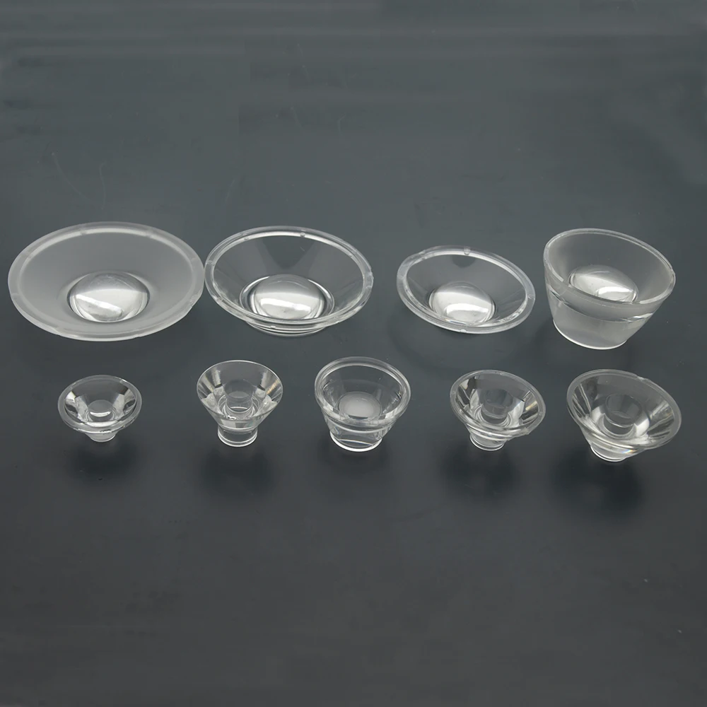

Which TIR fits the TS22? I’d be interested in trying that as well.
I also prefer TIRs. Lets hope that Simon makes a throwy TIR AA light!
It’s the 23,5mm lens from the link below. You have to sand the outer rim about 0,3-0,5mm and remove the centering gasket and then it fits absolutely perfectly.
Beamshot of the 5000K version, don’t look at the tint as my phone is terrible at capturing that, just at the nicely smooth beam :slight_smile:
8 Thanks
First, thank you very much for the reply and link.
Second, I have a question. There is also a 23.2mm TIR on the listing…do you think that would be preferable to start with compared to the 23.5mm one? Less sanding required, etc…

From what I recall the 23,3 didn’t work as the led opening was too small (just 7mm) for the xhp70 plus it’s a bit shorter as well (I ordered both optics thinking the same as You). It took me just a couple minutes on a random sharpening stone I had lying around so it’s not much sanding though :slight_smile:
Appreciate the info. Thanks again!
