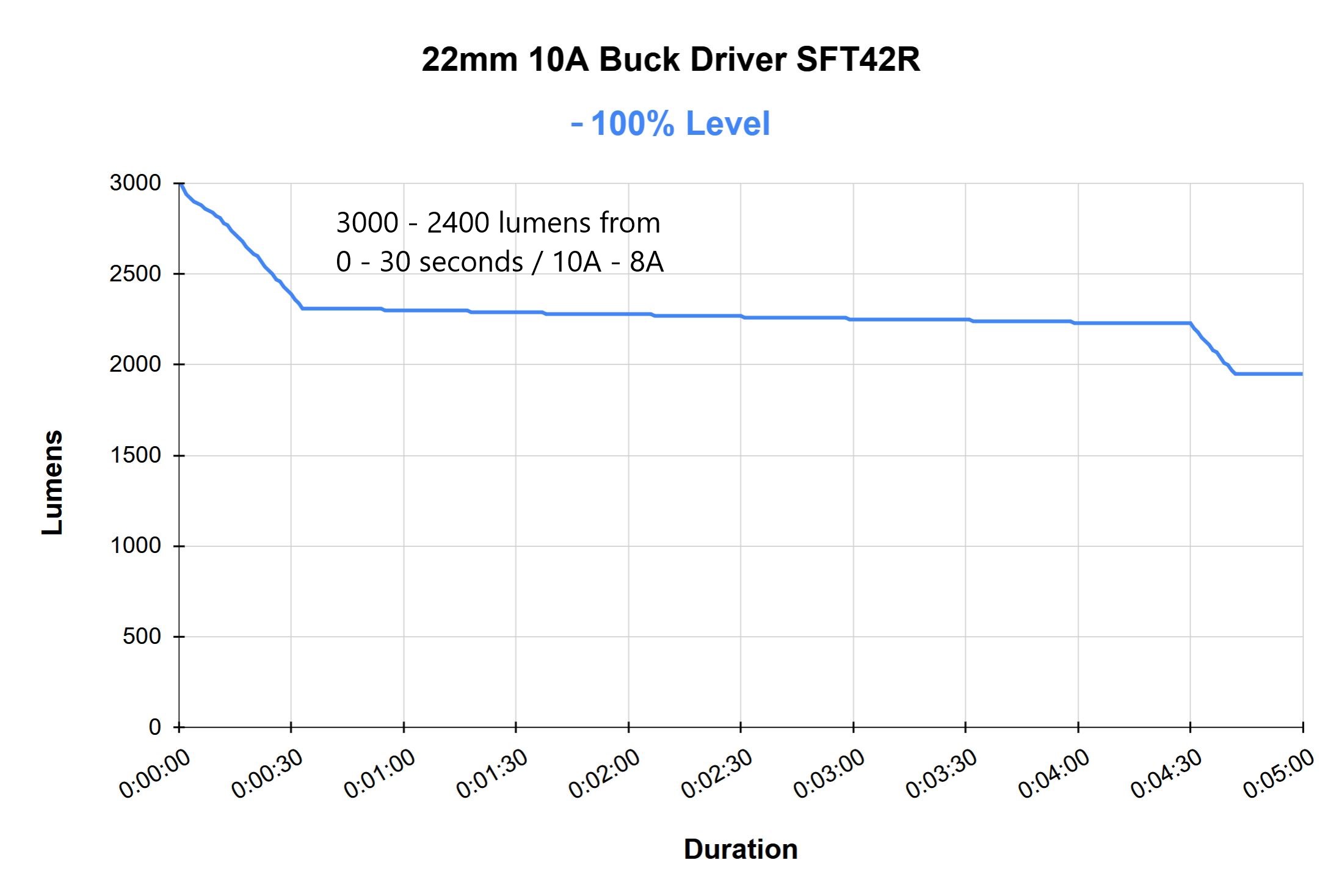

SFT42R at 8A with a 8-10A 30 sec burst is 5.5 minutes. It runs hotter, unless the 8A driver is doing something weird with the SFT25R.

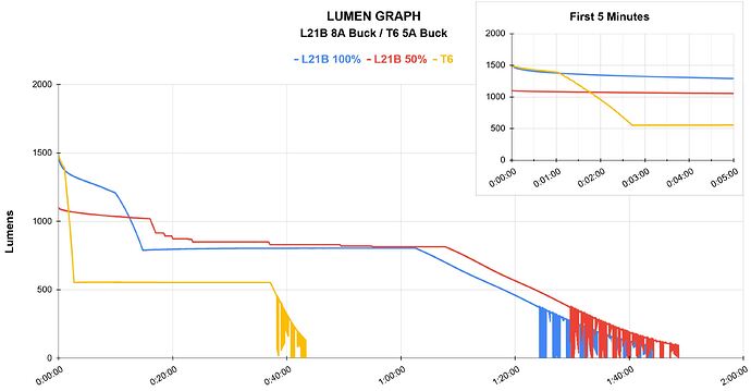

Either my lumen tube has an issue with measuring the L21B with an SFT25R or the 8A driver isn’t able to drive it at 8A. I only measure 1550 lumens and that’s what I measured with the T6 at only 5A.

Just had a look at my lumen graph of both 100% and 50%, the output at 50% (4A) is still way below the T6 with 5A driver. It’s very strange, both on L21B and C8+ with the 8A buck.
Graph of L21B and T6 with SFT25R

Could you explain? Is the T6 output in the graph at its 100%?
Yes, the T6 is at 100% 5A.
It’s strange that even with the 8A buck set to group 8 with a 50% level (4A), that the output is way below the T6 at 5A
I did try a 5A buck in the L21B when I first noticed this, the output dropped to 1300, so I have no clue what’s going on. Is it possible that these buck drivers have an issue driving the SFT25R?
Swapped in an SFT40 with the same drivers and they performed as expected. It’s only pairing an SFT25R it underperforms.
Well, this test I just ran was super interesting. The output dropped way below the usual 35% on other drivers. The temp remained at 50°C, no issues with heat here, the output reduced whenever the temp increased to 51°C.
35% = 2250 lms

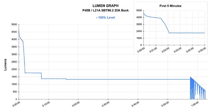

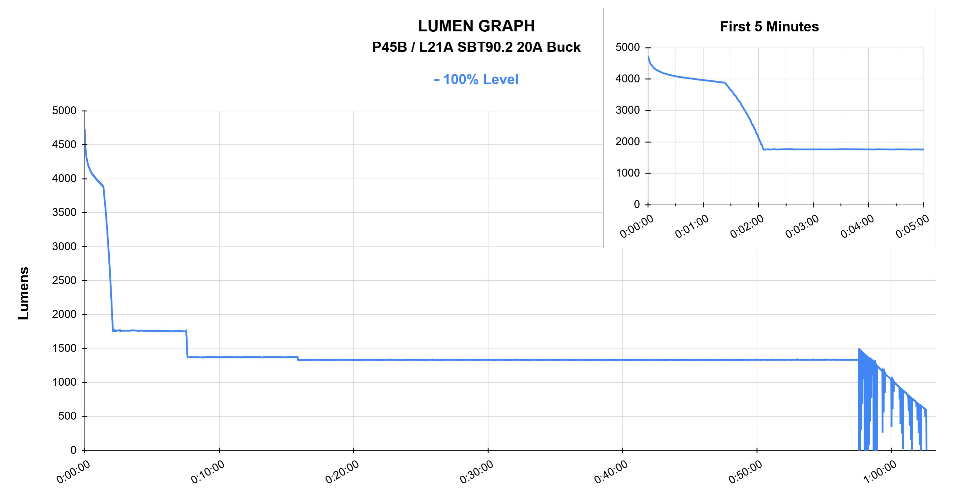

The 20A buck in my above graph doesn’t show this early stepdown behaviour either.

Below is runtime of my TS30S Pro with SBT90.2 reviewed by Sirstinky on 1lumen for comparison with the runtime of L21A above.
