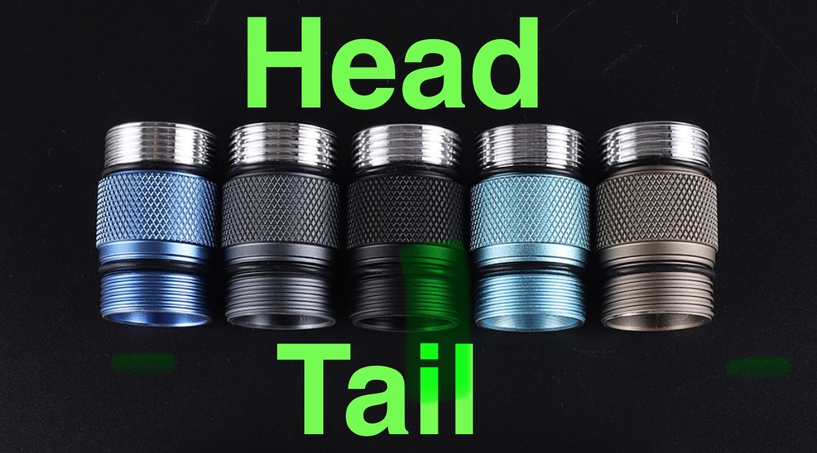

another problem I found, switching from S3 10A aluminum full tube (samsung 30Q) to 18350, the lux dropped by 20%, I thought it’s the vapcell M11 battery, but switched to stainless steel short tube it’s much better, I think it’s the aluminum short tube having threads and ends anodized, create too much resistance and voltage drop? also the tube is too short way too tight to screw on the tail…
Make sure you didn’t install the battery tube upside down:
Edit: The tail end is anodized except for the very bottom rim. This is to allow Mechanical Lockout.
yes that’s how i put in, i also tried opposite direction, same thing, I think it’s so tight, the end of the short tube can’t make good contact with the tail ledge, and the threads are anodized, that’s the problem, either make the tube longer (I actually tried not the screw in the head all the way and create more length, much better) so the end can contact better, or make the end treads un-anodized so it can make better contact with tail threads
What battery are you using? Is it protected?
said earlier, samsung 30q and vapcell m11, both unprotected cdr>10A
i measure the long tube ~48mm, short ~15mm, battery difference 30mm, so basically short tube is about 3mm too short, that puts too much pressure on the battery and internals
edit: I tighten the tail switch ring more, and it improves, so I guess the reason is short tube is about 3mm too short compares to long, and too much pressure, tail switch ring that press directly on the switch (there’s no stop shoulder) need much higher pressure than from battery so the contact won’t be separated
