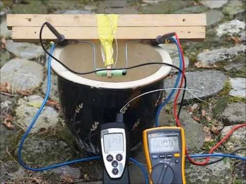

Where is a video shorting out a name brand battery?
I’m sure you can find one on Youtube using the search function there.
Here you go, the venerable Panasonic 18650
Drilling vent holes might not be the best idea as explosion isn’t the only issue with low quality cells. The gas that is vented can be particularly nasty in some cells, as in severe and permanent lung damage nasty.
The only safe thing to do with cheap nasty cells is to recycle them.

Interesting video. The most interesting part is: how did he get an NCR18650B without a PTC? One can't just remove the PTC from a cell that has one.
Shorting out cells with PTC is rather boring. They don't even get hot. That being said, cheap noname chinese cells don't have a PTC. Nor a CID, nor any other internal protection feature. Luckily, their capacity and current performance usually is so low that they don't vent even in a dead short. I've tried that a few times.
A bigger danger is an INTERNAL short due to lack of quality control (as Angler pointed out). At an internal short, all the current goes through a very small area (where the defect is), so it can reach separator breakdown temperature and then ignition temperature there. At an external short the current (and thus temperature) is (more or less) evenly distributed over the whole cell.
