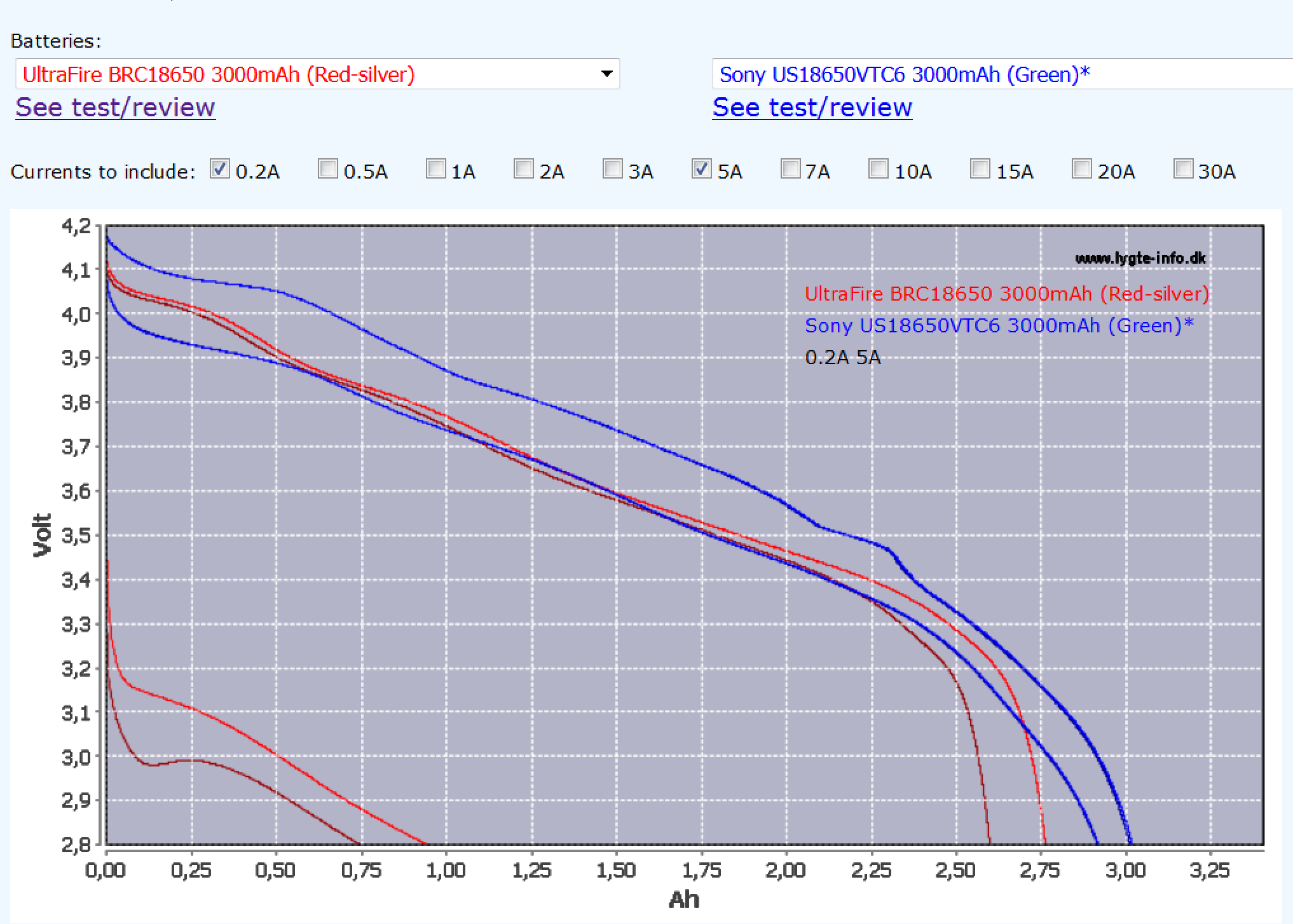

capacity is one thing but can the cell deliver 10 or 15A and is it safe for the case it gets shorted
Ultrafire 3000mAh
for example Ultrafire cell 2.75Ah at 0.2A discharge at 5A between 700 and 900mAh and no useful as the voltage sags like crazy after 20 seconds to 3.2V
