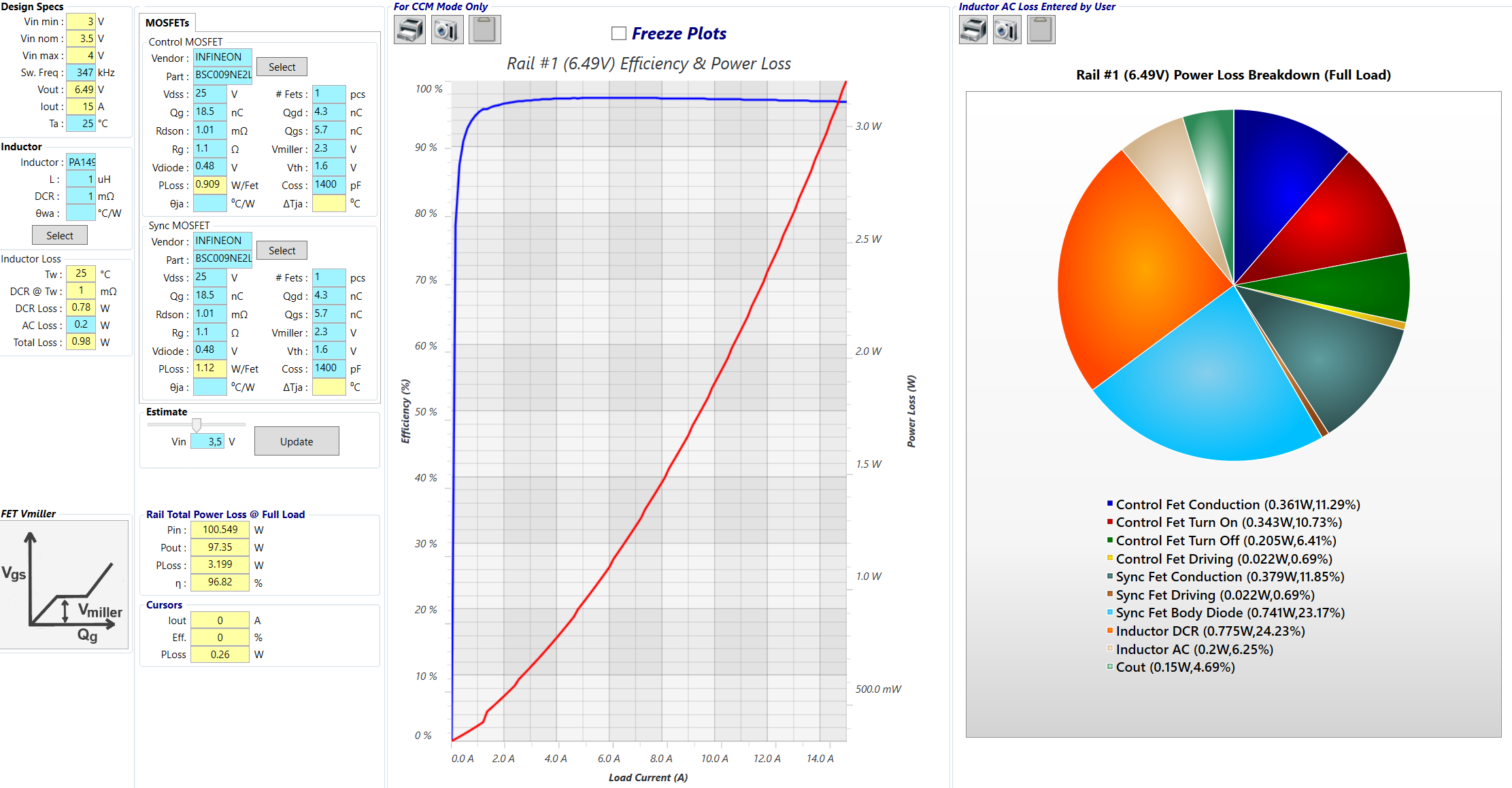

I started working on a LTC3786 driver for SP36 a while ago but I haven’t started routing yet :
LTPowerCAD simulation :
This is capable of much more power than MP3431 based drivers.
