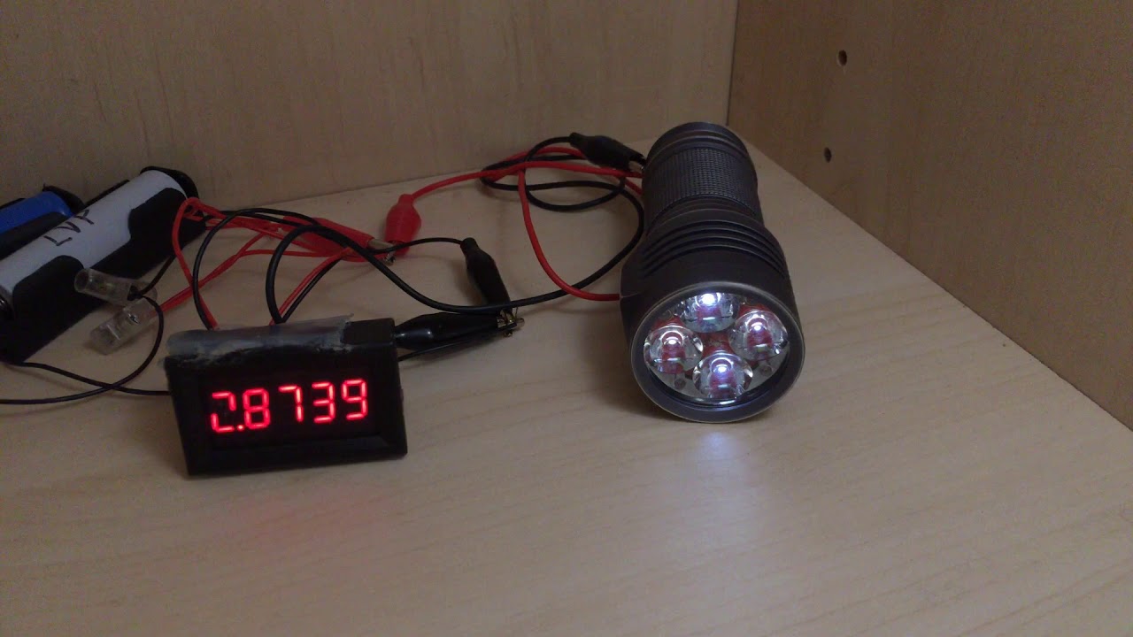

I just made a quick setup, and made a time lapse showing the LVP kick in.
The setup:
My 18650 “LVP” cell that’s always almost discharged, to test LVP, in a battery holder. Powering a D4S.
The blue 18650 in the background is powering the voltmeter. This makes sure the voltmeter is not drawing power from the main battery, skewing the results (pls ignore the broken led in the voltmeter :wink: )
To make it a worst case scenario, the AUX led was set to High. At full charge 4.2V, the aux (+MCU) draws 1,24mA.
As the LVP kicks in, the battery is at 2,87V. Notice the power draw from the aux is so low, the battery even bounces back a little. (and that 18650 is a 10+ year old cell)
At 2.87V the current draw was 0,0211mAh. And lets say, that there would be 100mAh left in the battery. That’s still over half a year to use up the remaining juice. And as the voltage gets even lower, so will the power draw.
SO YES, the D4S HAS LVP! :smiley:
And no, the AUX doesn’t (but the power draw is so freggin low)
