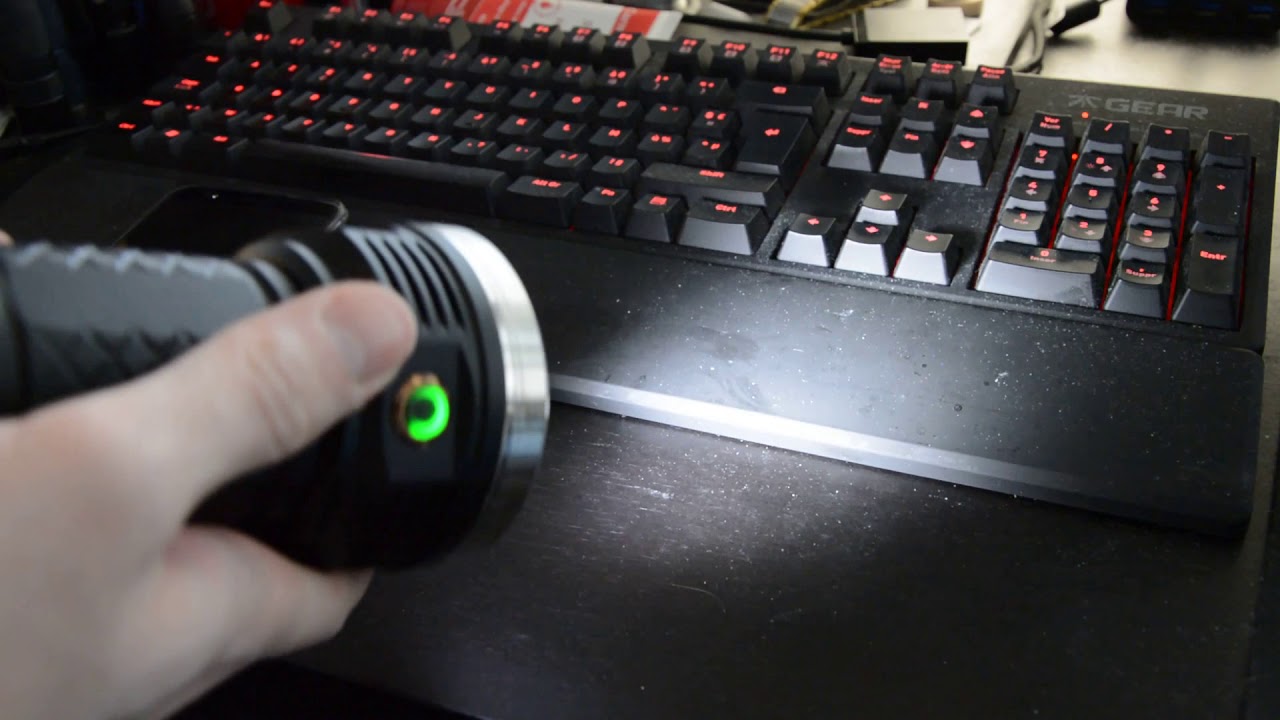

I recently received my MF-01 (nichia 219C version) and it seems like I got a defective V1.
When I press the button, nothing happens almost all the time.
Here is a video about my problem :
And now it doesn’t turn on anymore.
I’m using 4x fully charged Samsung INR18650-30Q.
What do you think ? Just a defective button ? Or driver ?
Are the batteries button top?
It looks like they are getting good contact, but I want to be sure. See if the carrier ends show 8.4v. It’s possible it’s getting 4.2v which could make the switch light turn on, but the driver may not work properly.
If that is all good, then it could be a bad switch. Since the switch works sometimes, I assume it’s wires are connected. I can also hear it clicking, so the rubber boot is making contact. You can bypass the contacts in the switch by unscrewing the switch bezel and pulling it out.
Someone who has taken this model apart can tell you which two wires to temporarily jump together to simulate pressing the button. If this makes it work reliably when you know you got a bad switch PCB. If it still acts funny then it’s probably going to be your driver.

I’ve tried using both button top and flat top and it worked a few times (I even managed to switch between the differents modes). I’m getting 8.3v currently so the batteries are making good contact.
I don’t have a small enought screwdriver to take apart the battery tube. In any ways the light is faulty and I will ask banggood for a refund or resend and I will then see what I can do with this unit (but if the driver is faulty I’m affraid there is nothing that I can do)

I’m now pretty sure the problem is coming from the switch because I was able to turn on the light and randomly switching between the different modes by using a screwdriver to push the switch (with cap removed), but it needed to be oriented in a certain way (like 45% from the bottom). Normal pressure from the top of the switch (90°) is not working so there is definitely a bad contact inside the switch or switch PCB.
