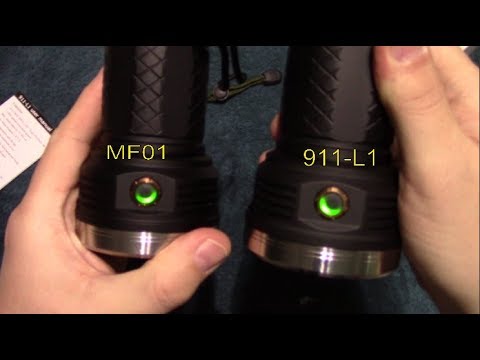

Charles just made a new video comparison to the 911-L1 and the MF-01. Haven’t seen it yet, but check it out.
Saw the video, They are both basically the same product, Wish I had jumped on the $47 price, it is now $71 and climbing! Will just keep using the Q8 as my flooder…

Mode 4 and Turbo on the MF-01 mops the floor with the 911.
Luck of the draw, everyone who has ones says they are the same light.
As far as I know, the mode 4 and turbo specs of the 911 coincides with that of MF01 V2, relative to that of MF01 V1. The “problem” with mode 4 of MF01 V1 is that it’s ~5000 lumens, and is going to step down quite rapidly to ~2000 lumens, even thought the body of the MF01 should handle more heat/lumens.
The mode 4 of MF01 V2 is ~3000 lumens, and the light is able to maintain this output continuously, at least when I tested it a couple of months ago. So specs wise the 911 (or MF01 V2) has lower output in mode 4 than the MF01 V1, but it is a much more usable output.
I have also tested a turbo output of ~9000 lumens for V2 compared to ~10000 lumens for V1 which again is in accordance with the relative specs of the 911 compared to the MF01 V1.

I prefer the modes on the 911 over my Version 1 MF01. And the slight difference in lumens on turbo is very hard to notice with the naked eye when you are already in the 10k+ lumens range.
Received the Amazon light today, exact same as Astrolux, price is now $109.95.
