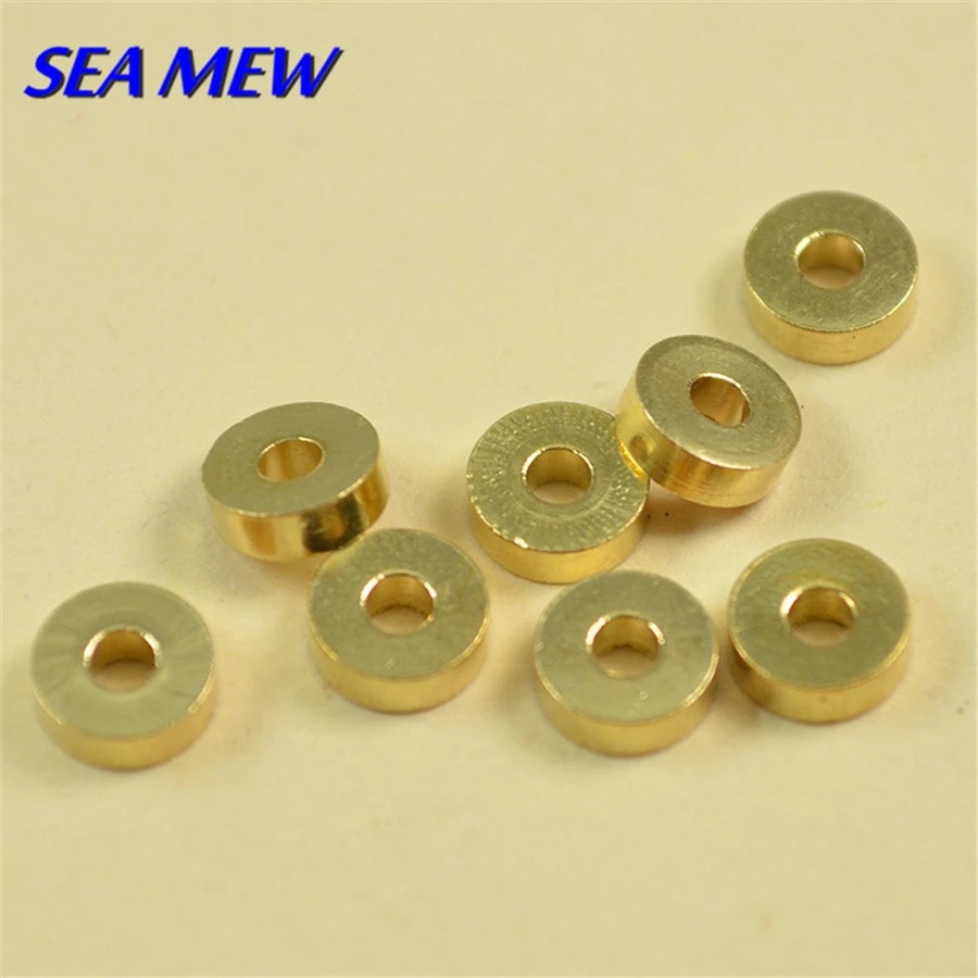

Just to be sure I have ordered a pack of these that I will solder on top of the cell.
I think it’s better to have a flat surface then an uneven surface that a solder blob makes.
Just havn’t arrived yet.
Made of brass. Checked with the seller.

I think the best thing for Goodfellafin is to either get button top or else get flat top and add solder blob. Assuming he can solder. This way you can keep the polarity protection and not accidentally fry the light.
You also don’t risk getting bad contact from using a flat top that may or may not always make contact. I would rather be safe than sorry.
Solder blobs get excellent contact. They start out as a dome shape but kinda of squish down a little to flatten out the top. Or you can run a file across the dome to make it flat.
