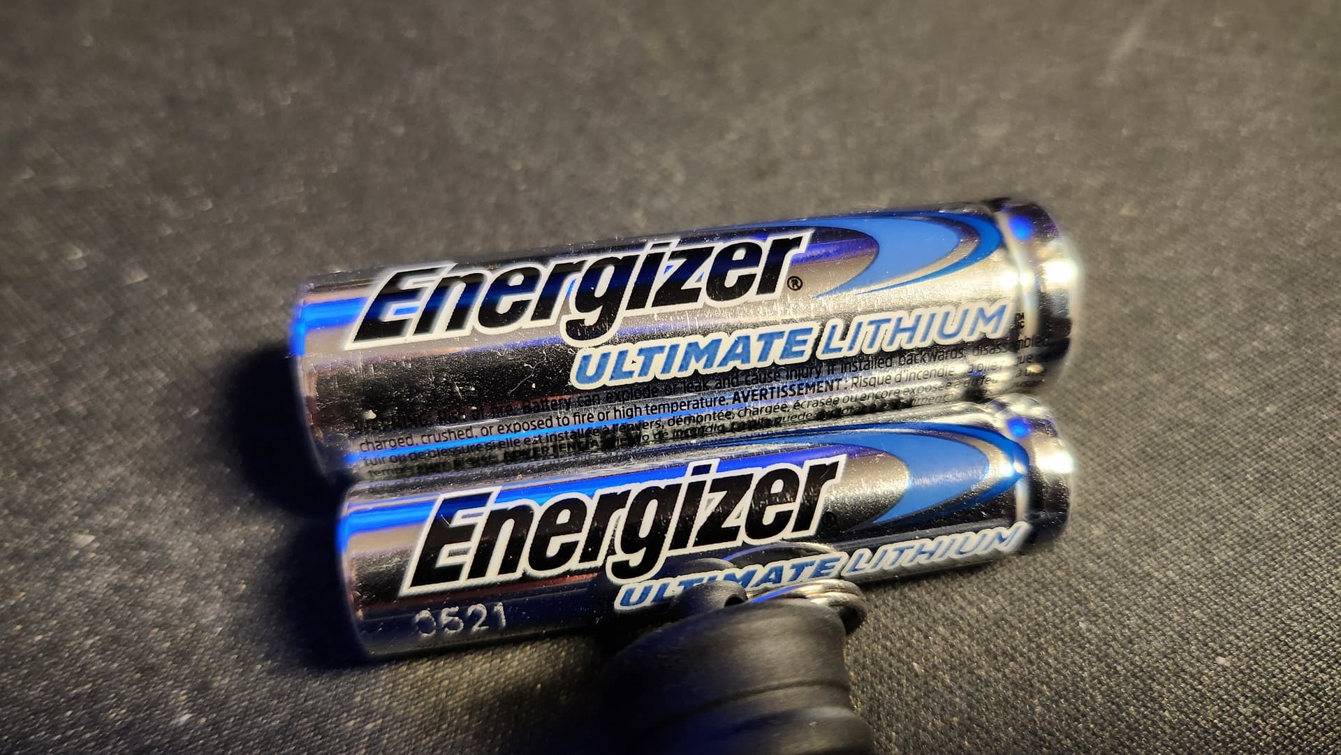

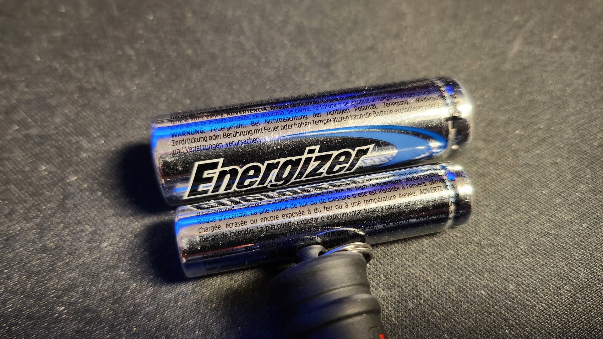

Looks like a fake. I cannot say why, but something looks off to me while watching the images…
Would also explain the really bad performance. Are you able to measure the draw current of this water leak sensor?
Where they were purchased from is a better indication of whether they are fake or not.

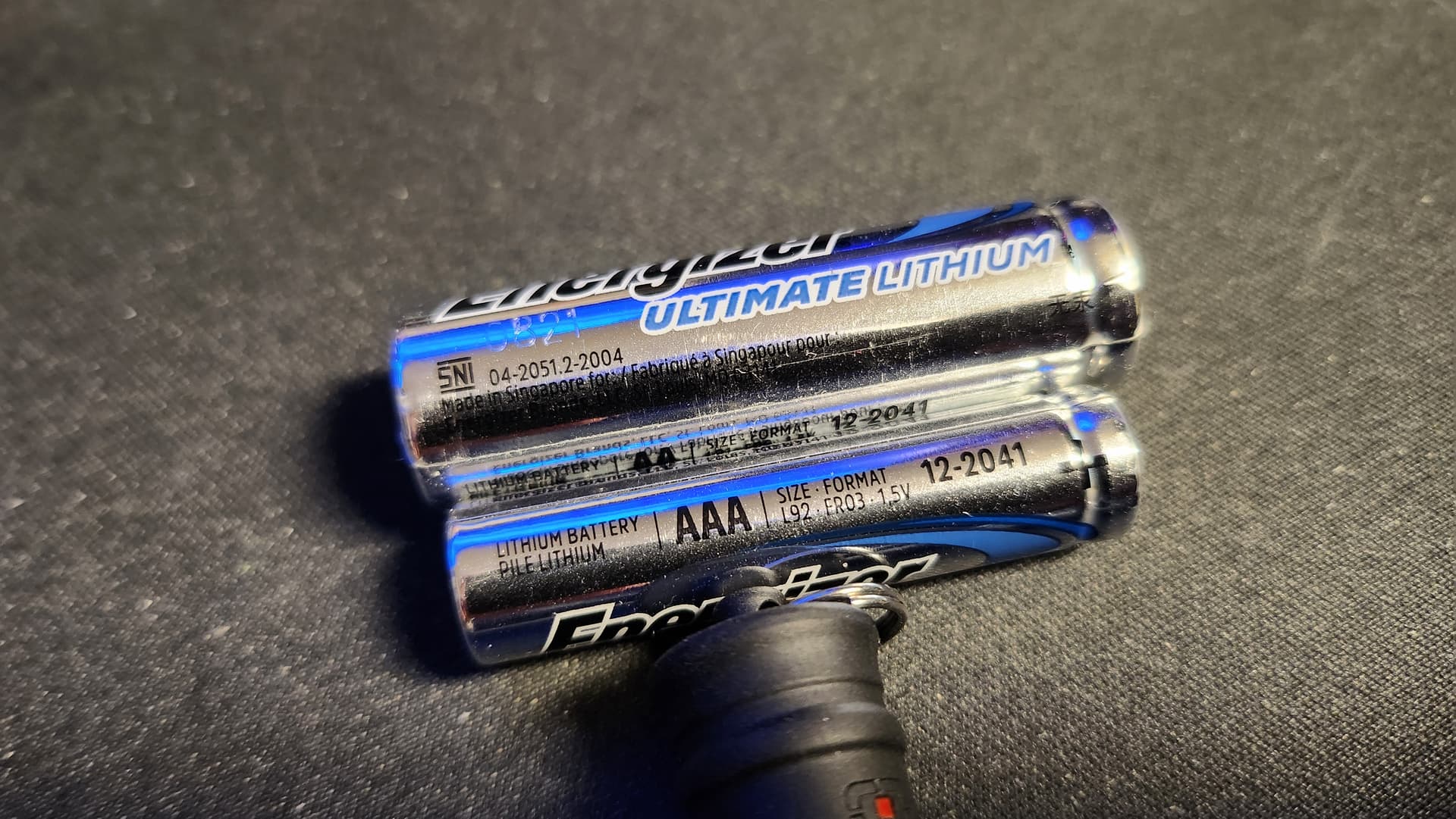

That black bar is the expiry year, so it should be 2036. I dunno, it still looks kinda off to me…the only other thing I can think of is you mentioned a previous leak inside the device, and these cells are draining like crazy in it. Something could be causing a short somewhere, like residual electrolyte, etc.
The scale measurements seem pretty consistent with the generally accepted weights…Does the same issue of fast drain occur with NiMH? And if you have a multimeter, could you check the resistance of the circuit sans battery? If it’s suspiciously low, there very well could be a short somewhere.

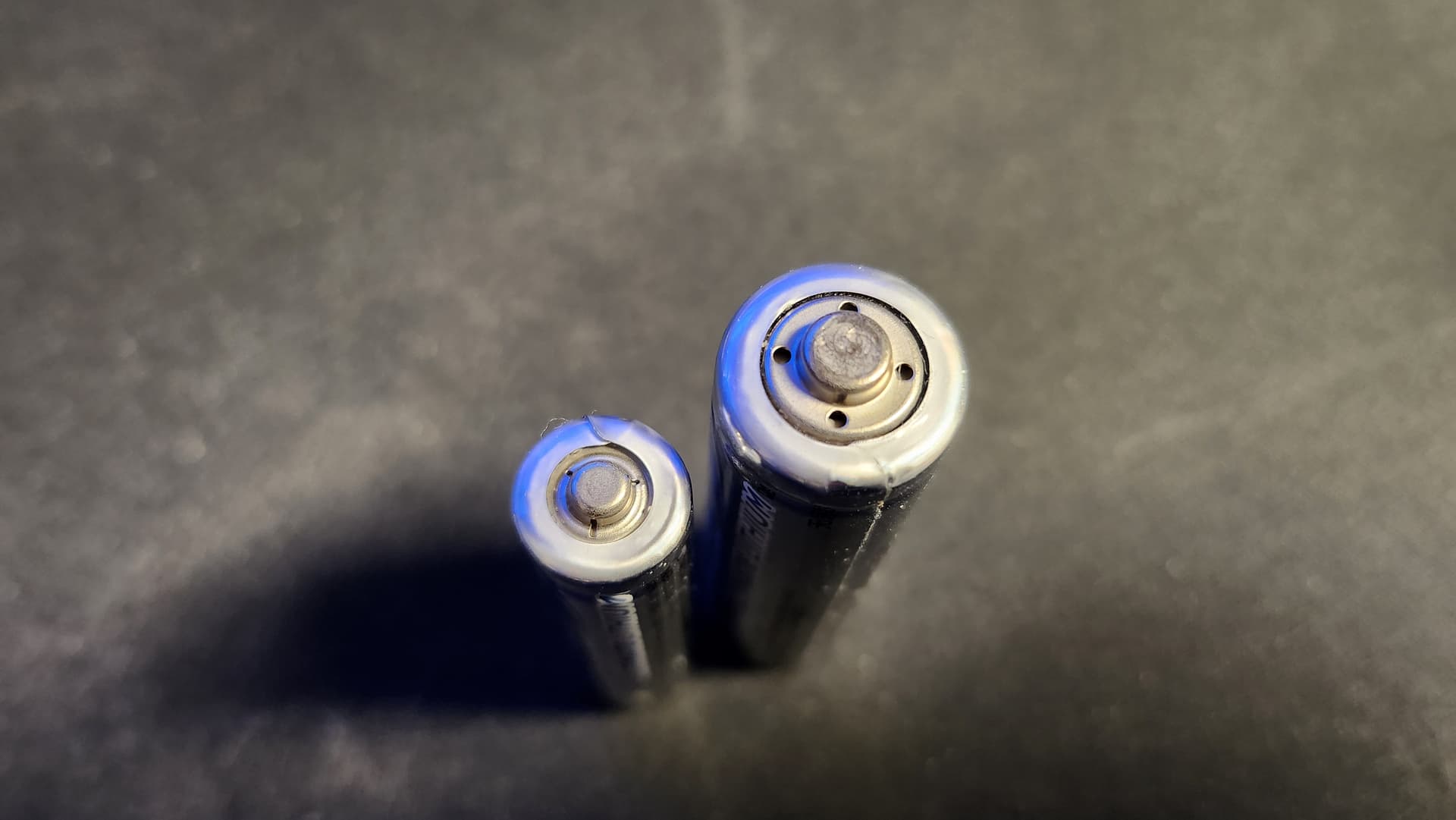

ALSO…could you take a picture of the top of the cells at a skewed angle, a.k.a. the positive terminal?
Here’s one each of mine, AA and AAA, guaranteed authentic.

The vent holes look legit, lol…please keep us updated!

Regarding to the weight of the Energizer Ultimate Lithium batteries (I only buy these from Amazon).
On electronic kitchen scales with a definition of 1 gram they weigh (per 4, no package)
AA (ult. date 12-2049): 60 gr.
AAA (ult. date 12-2042): 30 gr.
