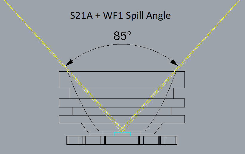

Most reflectors are not particularly tall relative to the diameter, so the spill angle is pretty wide, but there is still a sharp cutoff like you say:

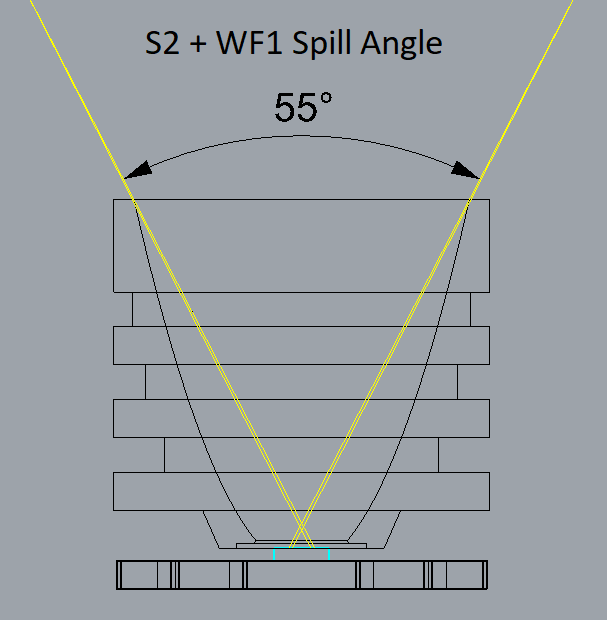

Taller reflectors have a steeper spill angle:
I think a small optical component could be glued to the center of the glass to create diffuse omni-directional spill. This would be worth experimenting with to fine tune the beam of reflector lights.

This is a really nice idea, I’ve done it with a too throwy TIR. It also occurs naturally on cold days when the water vapor in the reflector chamber condenses in the center of the lens. As long as the diffusion applied does not extend past the truncated center of the reflector, no throw is lost; even a decently bigger diffusion piece results in minimal loss of throw.

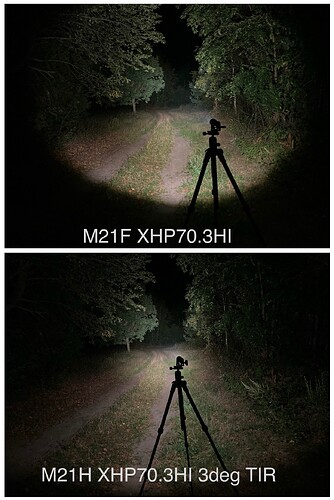

Question: has anyone tested the output difference of the M21H XHP70.3HI vs M21F XHP70.3HI? I’d be interested to know if the TIR setup of the M21H gives it any deficiencies.
Testing with other LEDs is fine, as long as the CCTs, CRI and battery ratings are the same ![]()
I have numbers from M21E (measure very similar to M21F, at least with GT-FC40) with Cree XHP70.3 HI R70 4000k LED in case you find it helpful. I have M21H also but only with 219b sw45k. I measure with Texas Ace lumen tube, which follows pro reviewers’ numbers closely enough.
JP40-AM04 3080
Nightwatch 45XP 80A 3060
Molicel P45B 3040
Higher drain battery doesn’t seem to make a big difference with this LED. I like it very much. Low CRI but very high output and 4000k version has beautiful tint, also very cool running.
