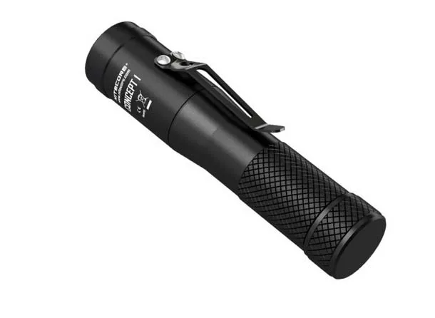

The long ramp from the front section, down the tube, makes it look like a Nitecore Concept 1 or HDS Systems EDC Rotary. Not saying I don’t like the style, I do, it made me buy the Concept 1, but Fritz’s design is cleaner, neater, more business art and unique. The custom straight off the lathe look is what drew me to it in the first place.
