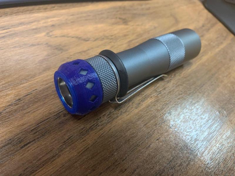

I suspect I got two of the first generation ones, One Grey(user destroyed) and the Blue pictured above.
I will elaborate the word shattered, it did not shatter from dropping it, I shattered it bit by bit using the wrong tool. I did try pushing and pulling it off before resorting to force. It broke along the thinnest part between the diamonds when trying to leverage it off with a jewelers screwdriver. The nubs on the first ones really hold on to the groove of the tailcap!

The magnet measures exactly 20.0mm
The 3D cap measures ~ 20.35 - 20.55mm
It stayed in pretty well and took a little effort to push it out once set into the 3D cap.
