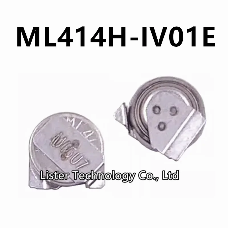

Bad news: It seems like the specific supercap we wanted to utilize for the GFS16 isn’t available anymore.
Good news: I found a source for the original 3V lithium-ion coin cell battery! Not the absolute best, but should work for a low 10x production run for the PCBs I still have :slight_smile:
Even better, it seems I managed to find a newer rechargeable coin cell that has higher energy density. The only problem seems to be that you need a spot welder to connect the tabs safely: since I have one, it doesn’t matter to me.
