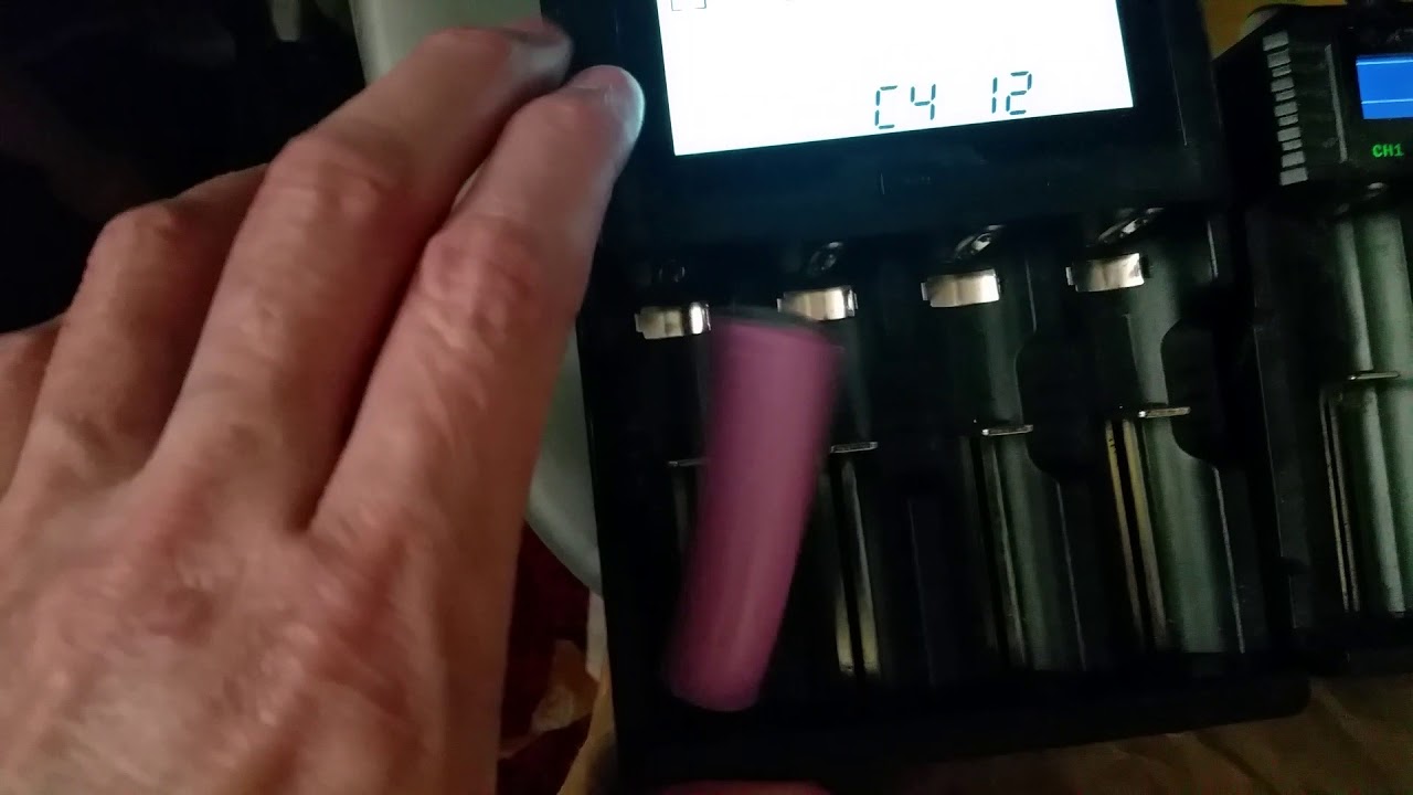

No, I meant— are the poorly-welded button tops from Mountain Electronics safe to use “as is”?

They should be safe. Remember that when you put them in the flashlight they are under a lot more tension than in the charger. So the button tops are pushed harder onto the battery. So it’s possible that the internal resistance goes down to normal levels when inside the light.
The voltage is always balanced among the 4 cells so you don’t have to worry about that.
If some cells still have high resistance while in the light it would just reduce the amp draw a little bit. So if 4 solder top 30Q each draw 4A on turbo in the Q8 equalling 16A total then these cells might only draw 3.5A and only give 14A total. Kind of like the extra resistance you get in a protected cell. I don’t think it would hurt anything. Just reduce max output.

I finished the solder blobs on Mike’s 30Q’s (and made videos of that as well) and the new results are great. Check out the resistance I’m getting in my C4-12 with his cells.
If you don’t have time to watch, they are:
23, 27, 26 and 26 milli ohm.
That’s pretty darn consistent, I checked a few times and I might see a 35 or 40, but it never got higher than 40. :+1:

If anyone is interested, here are some other videos that I made showing how to do a solder blob as well as installing shrink wrap.
They are not professional videos, but they show the important stuff.

I’m thinking you all were right about the bad button tops.
Btw…. what were you getting before you did the solder blobs?
