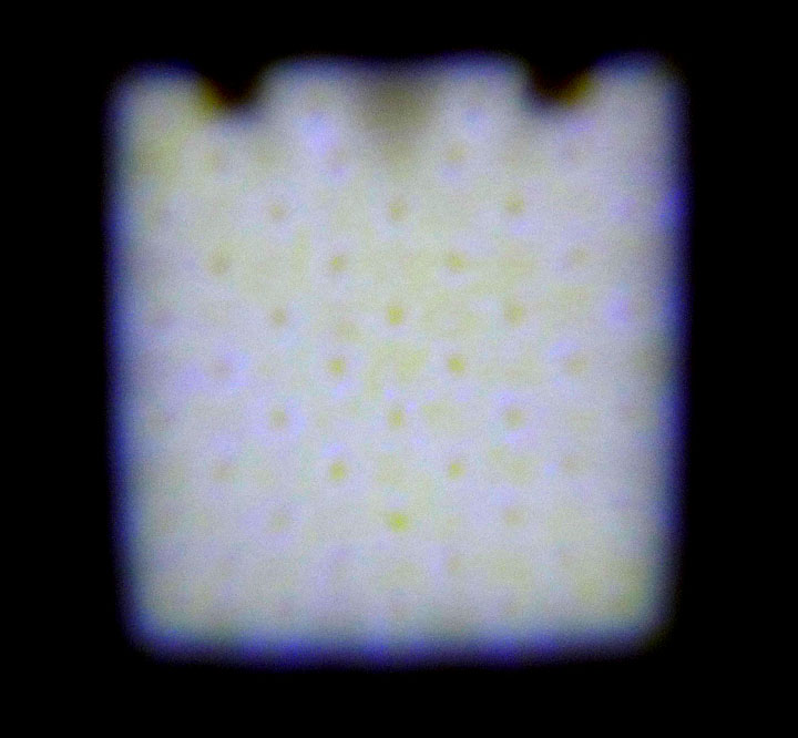

Yes, yes, but the emitter projection of the L2 looks much different than the T6. Instead of a latticework (don’t know how else to describe it) in the T6, the L2 has tiny dots in tiny squares. Six dots across by six dots down. I’ll see if I can post a picture later.
I only have my phone here which takes awful pictures, but here you can see the dots in the L2 emitter when used in a zoomer. Looks mucho different than the zoomed image of a T6 emitter.
Maybe luvlites would like to step in and tell everybody they are wrong again :slight_smile: LOL
