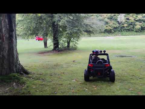

Here my 4 yr old on his with yk31 controller and softer springs
Thank you as well for posting the springs. I ordered some shocks from Amazon but were over $130, they are probably still too heavy, and won’t get here for a month. I ordered these springs as well, thank you.
