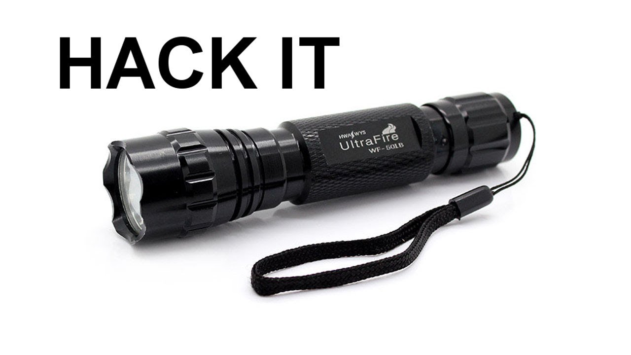

I had some time yesterday so I saw some reviews on youtube,
and I wasn’t very impressed of the wf-501B throw. (Curenntly it’s 25$ for everything I need.)
I saw the ultrafire C8 which is much better thrower,
but but almost couldn’t find any with 1 Mode (I defenitly need 1 mode only)
Is it possible to mod 5/3 mode to 1 (High only)?

It is possible to mod it to one mode, the way this guy makes it is just a direct drive…you often can simply remove a capacitor or do other mods if you have a soldering iron…

It can be modded to one mode by bypassing the controller, that would give you always high 2.8A.
