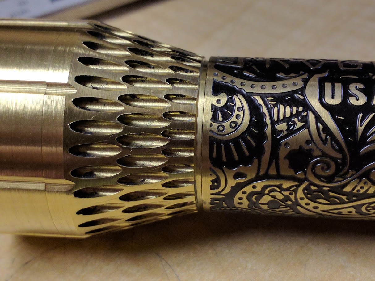

Holy head (finished)
Well done, PP. I’m always amazed at your creativity and excellent execution.
Thanks gchart. I’ve stalled for a bit trying to work out the tail. I have a design in mind but not sure how it will all fit together.
