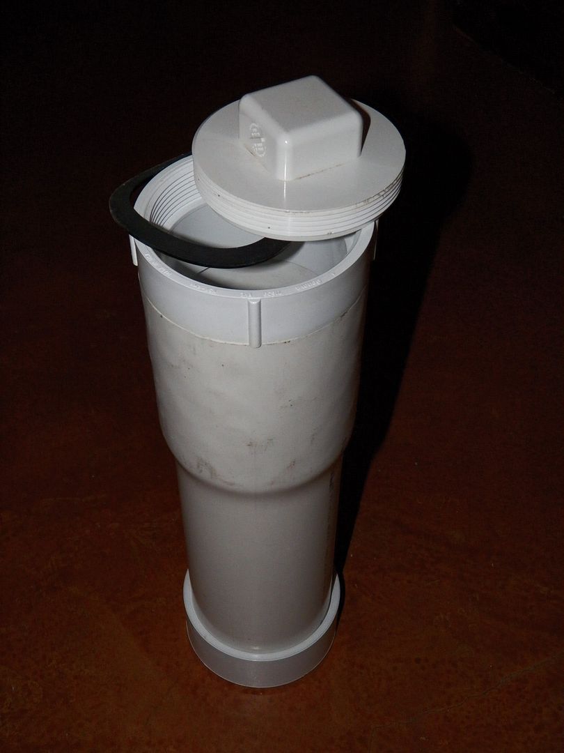

Well…I went out and purchased most of the items for this sucker:
This pic has:
1 x 4” tube by approx. 16” flared piece of schedule 40 PVC pipe.
1 x 4” end cap.
1 x 4” internal fitting with threads on other end.
1 x 4” threaded screw plug.
1 x 4” rubber seal.
1 x Oatey PVC cement (I have some primer somewhere around here).
1 x Fox HP pump (already had that for shock on my MTB).

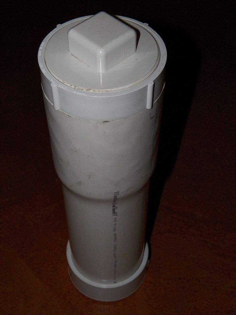

This is what it will look like open and closed, sans valves.
I have two of these Schrader valves coming which I will mount somewhere…probably on the threaded plug. One for an Ashcroft gauge I have laying around here somewhere, and the other for the HP pump.
I have lots of questions, but the most important one is…am I crazy?
