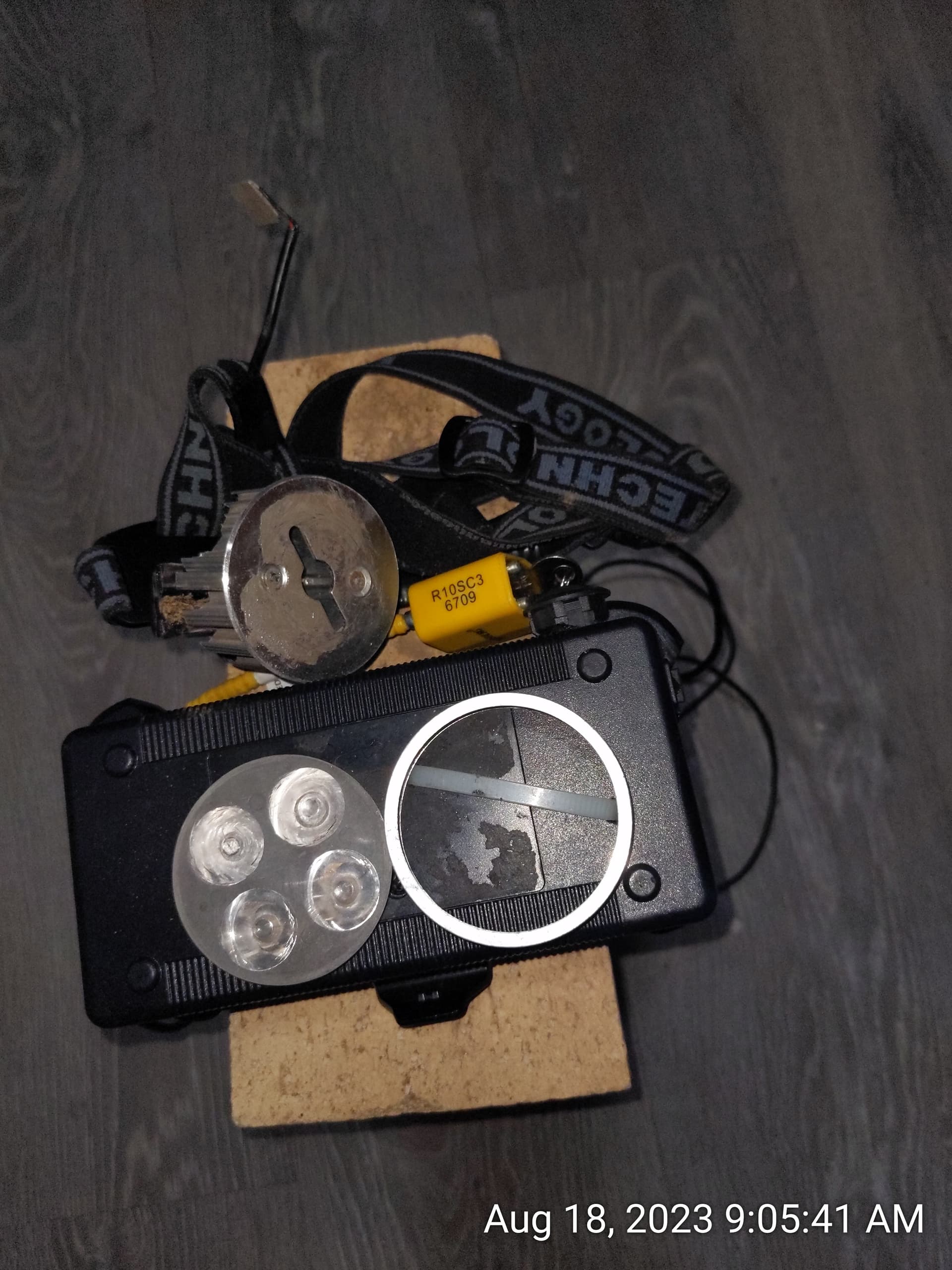

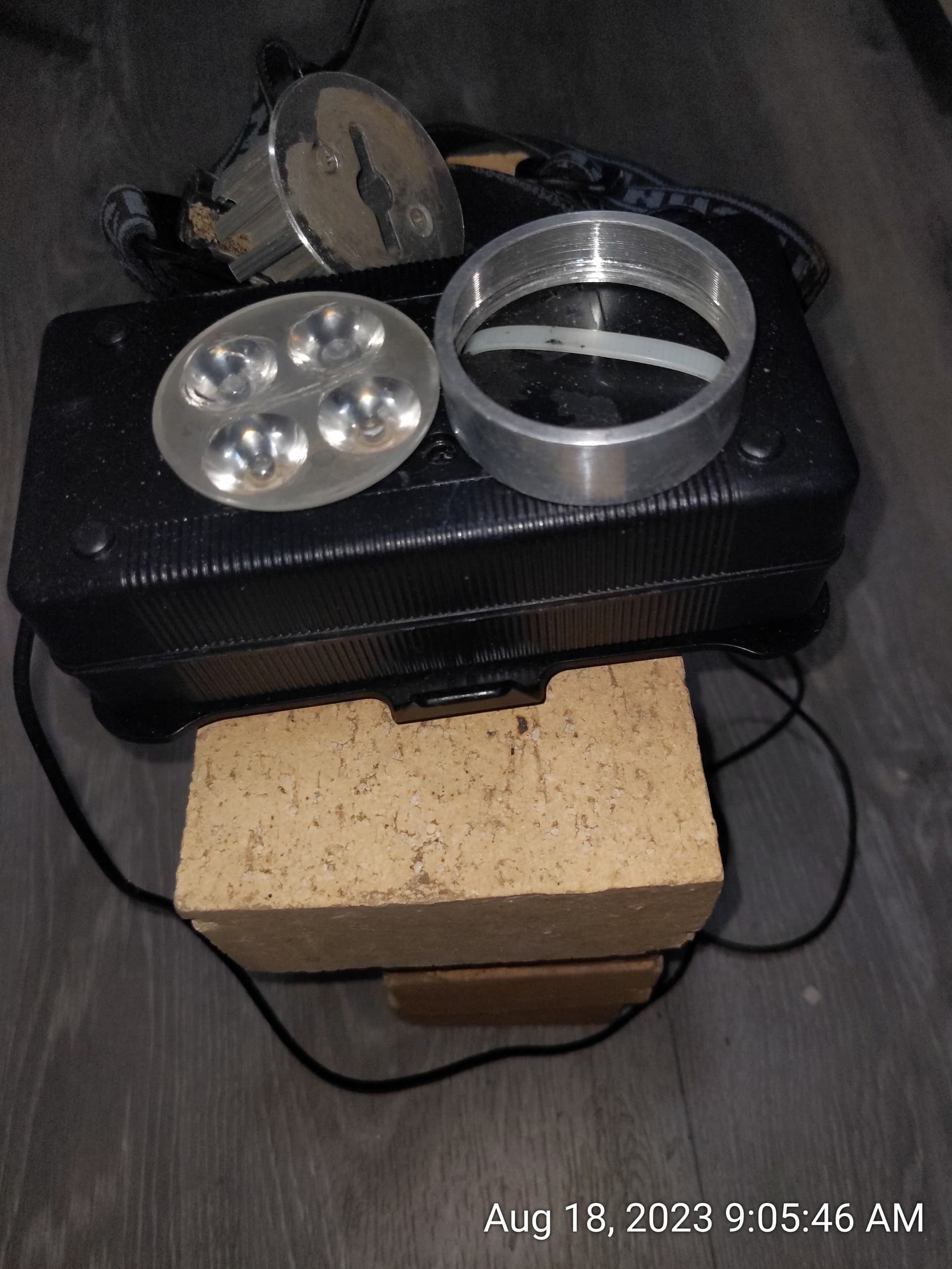

Just so everybody has an idea of what this thing looks like, here are some pictures. Ignore
the yellow lock, it’s my gun lock I Am clearly not using at the moment.

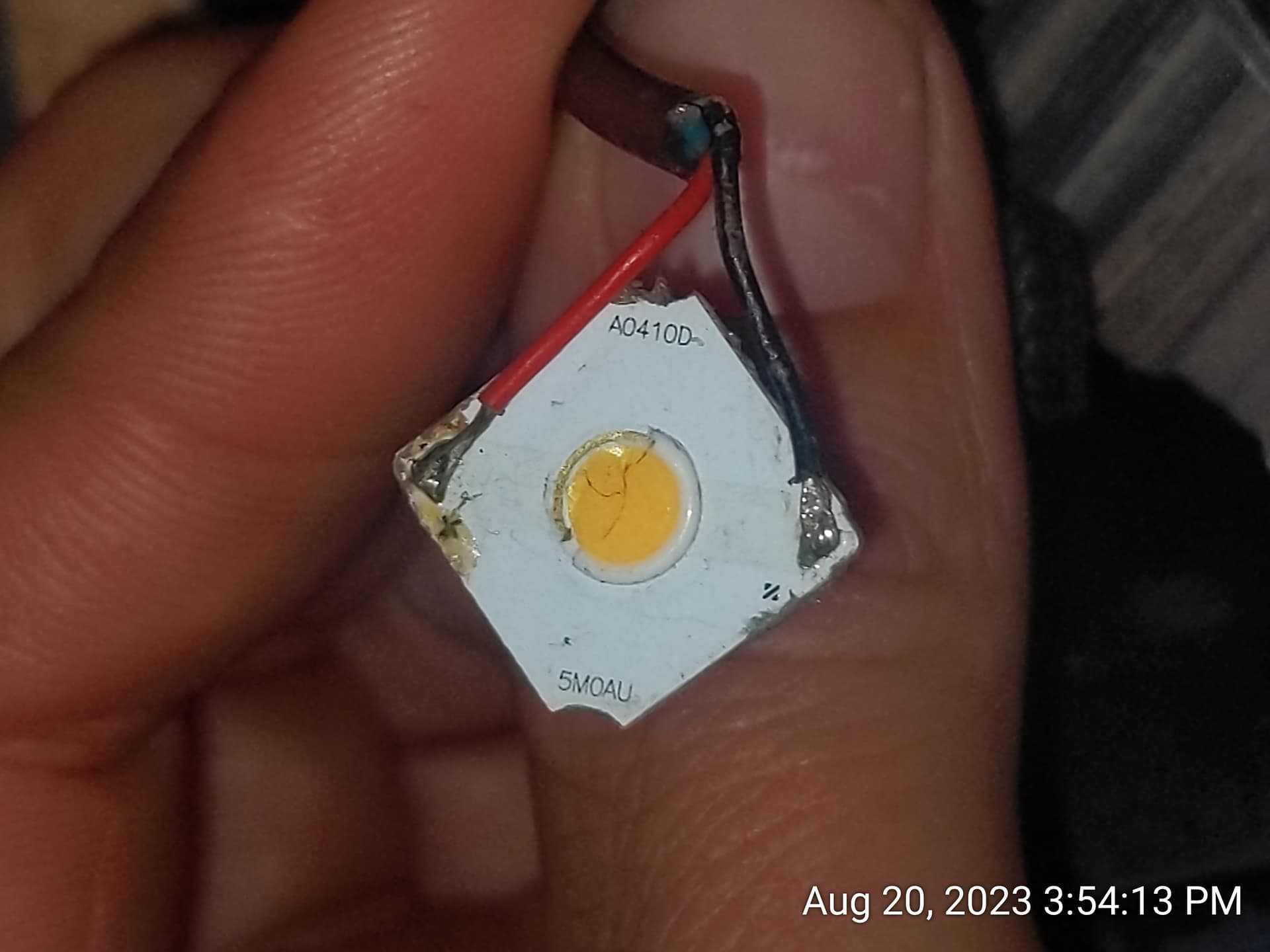

PRetty sure I broke the LED, tooling around, the hack that I am. MAn that blows, the shipping from digi key hurts.
Maybe a stupid question, but does it still light up?
How did you do that? Might help me avoid such problems in the future.
it does not light up, IT happened because I used that lens you see pictured. The LED is super fragile and I should’ve known better. I will not make the same mistake next time. I will be careful not to have anything touch the actuall yellow LED area

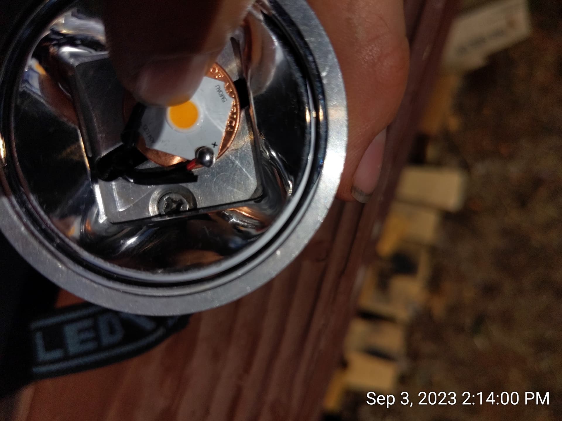

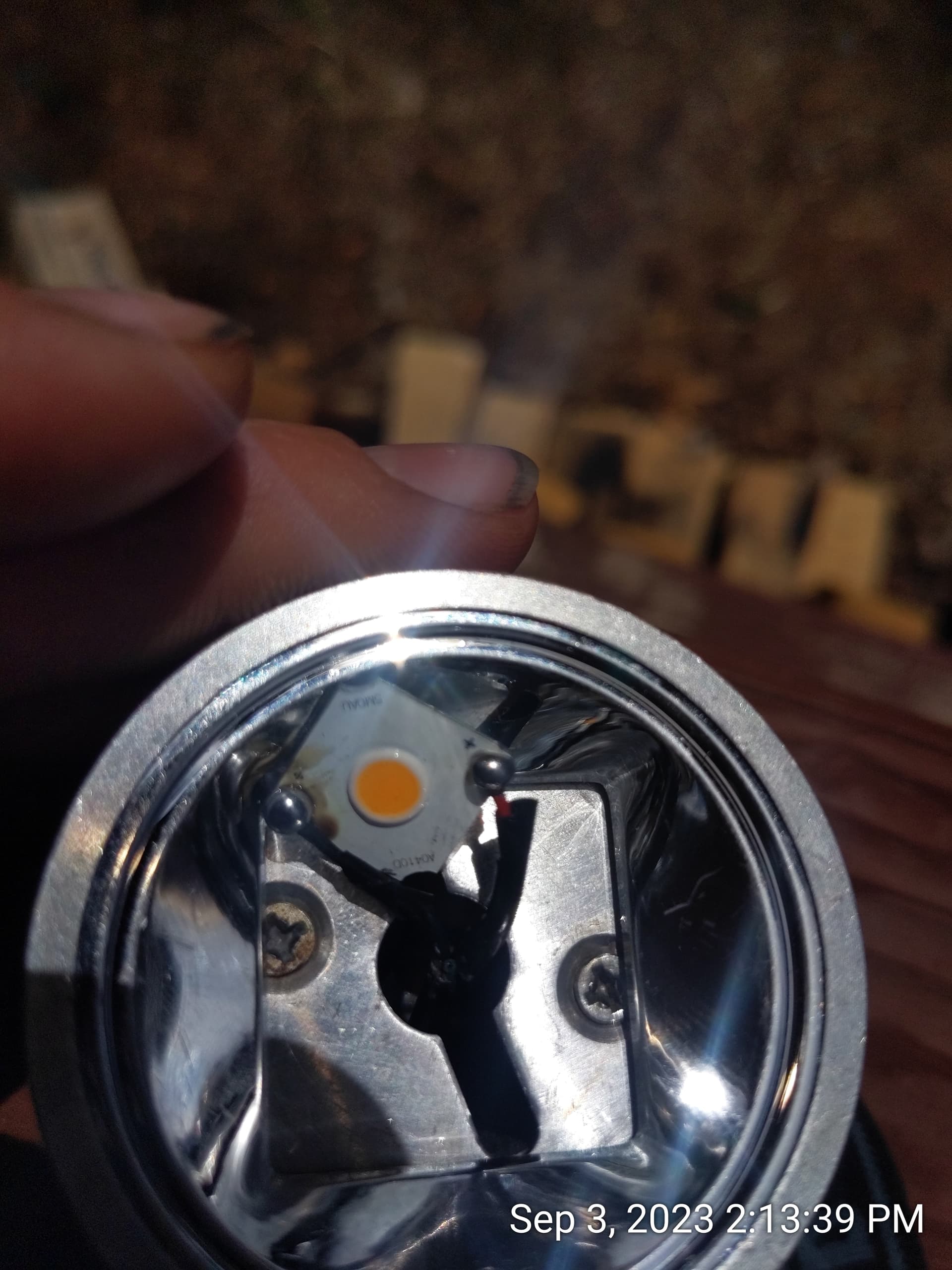

I got all the parts from china finally but now i have a problem. A quck test revealed the lens / reflector works, but im trying to figure iut the heat sink. If i put a COB LED OVER a big old hole like that,will it stay cool? Or should i thermal ADHERE a penny in there in between the hole and it? Not sure if that will help much.please get back to me soon, im eagee to get the light up snd running again
How will the LED be held in place and centered?
Maybe solder that penny to the heatsink.
That plaster stuff you have a picture of probably will not conduct heat well. In any case it is intended for a very thin coat and for the two pieces to be held in contact mechanically. Not to fix two parts together. Heat conducting epoxy would be better, but still will not conduct heat that well.
Will the penny screw up the focus? Maybe route out the heatsink and set the penny flush?
You do need flat and clean surfacess to conduct the heat away. Thermal compound or glue is only to fill very small gaps. And pennies are no longer made from cooper. I suggest to look for a aluminum plate that just fits in the cutout or even better one that covers your entire heatsink.
