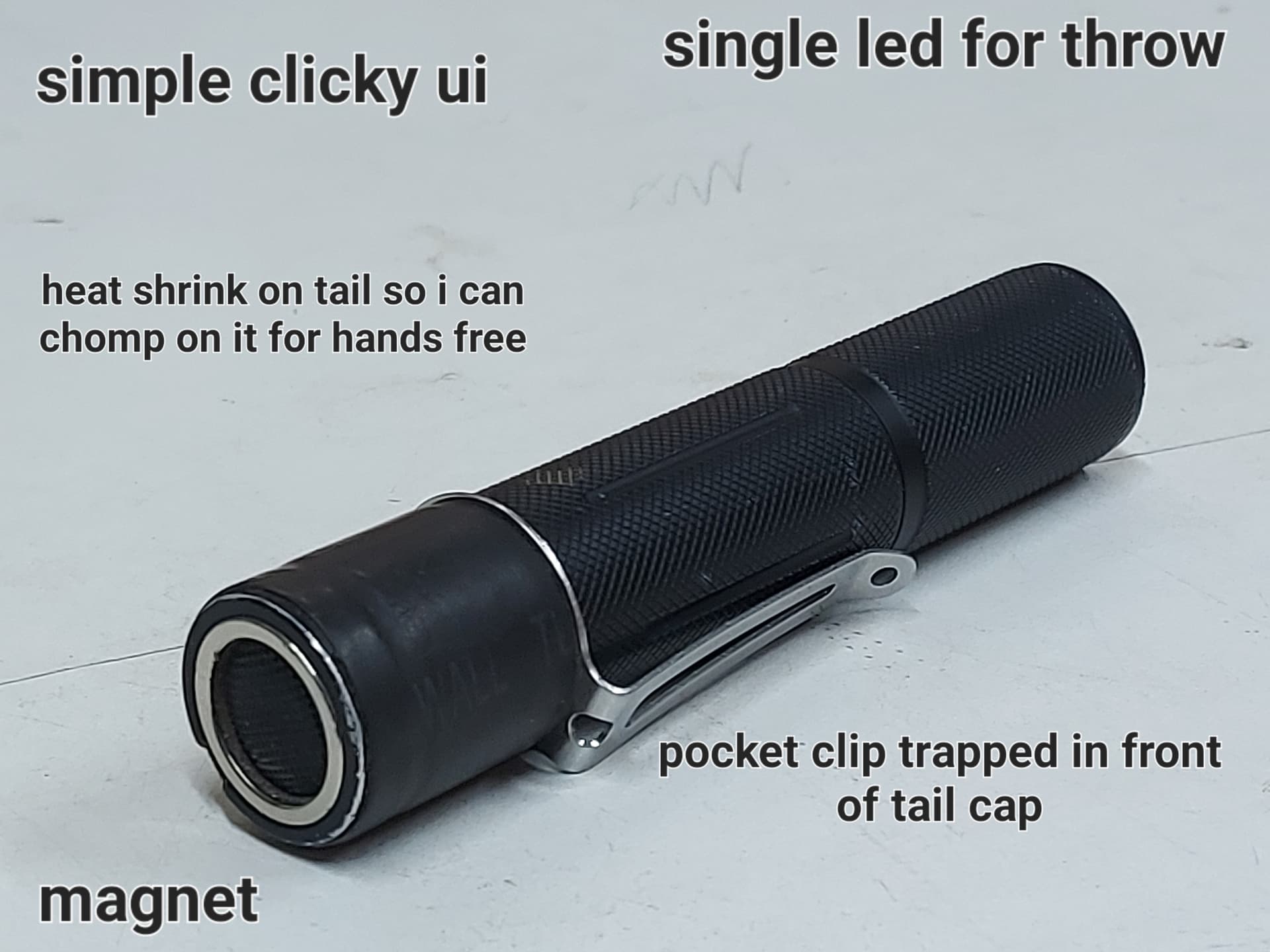

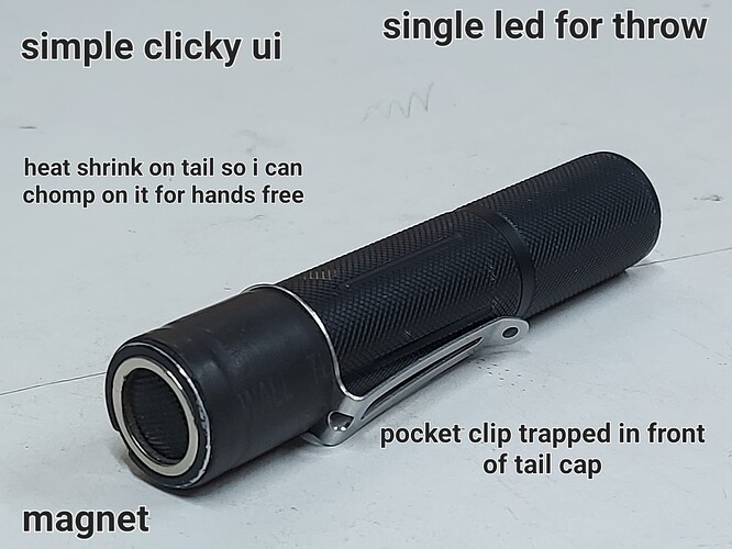

Nice to see you’ve taken that with the good humour that was intended. I’ll put forth my preferences.
The short answer
I prefer tube lights, aluminium, 18650 or 14500 replaceable batteries, simple clicky ui with LVP, sturdy pocket clip, flood to throw beam for 18650 / throwy beam for 14500, no aux lights.
The long answer
This is an everyday carry, not a bedside light nor a camping light, not even a movie theatre usher light.
Tube and battery
I like slim, 18350 just feel short and fat. Hence my battery preferences.
Aluminium
I have a penchant for jewellery lights but not for edc. EDC also used to be called beaters. I don’t want to worry about pampering what’s in my pocket.
UI
EDC’s are there to produce light, i don’t need to screw around with fancy candle mode when i need light. Just hit the tail switch and get on with what I’m doing.
Pocket clip
If it’s getting carried around with me all the time the pocket clip better hang on. I work in construction so if the light can’t hang on it’ll get dropped and lost.
Slightly throwy beam
EDC (every DAY carry) i work daylight hours so my use case is usually looking in dark places like the back of a sea container or in a ceiling space where my eyes haven’t fully adjusted. A throwy beam helps me focus on what I’m looking at.
Aux lights
On an edc doesn’t make sense to me… I’m carrying it, why do i need aux lights in my pocket?
Usb charging. If it’s a silly silicon flappy cover then NO. If it’s in behind the threads and waterproofed by the oring then okay but i don’t ‘need’ in light charging.
Currently edc’ing a convoy s6

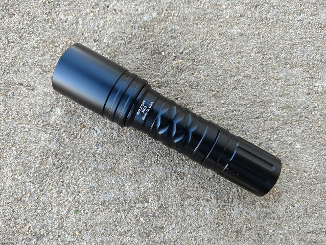

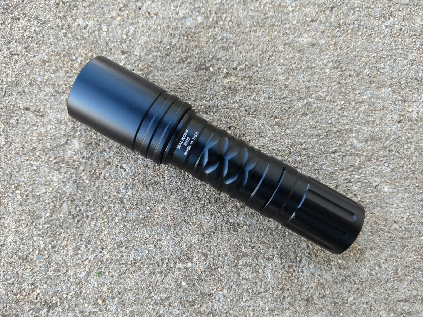

As far as I am concerned, an EDC light has to be utilitarian and ultra reliable. Cool has no place in the EDC world. You want a light that you can count on no matter what the circumstances.
If it sounds like I am describing a Malkoff, I am, but there are other as well as mentioned above.
