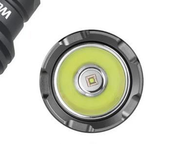

The TS12 has a 33mm head diameter but only 432 meters of throw, which is far from the best one can do. From the product page one can see that the reflector is not focusing correctly: lots of area in the center and near the edges is not lighting up. Plus the very thick but optically inactive bezel.
Screenshot 2024-10-16 090439
A Convoy S6 with the same emitter can easily get the same throw if not more, and be only 24mm in head diameter instead of 33mm.
I have no way to accurately measure it, but I have an S6 with a CSLNM1.F1 in it that throws way further than it looks like it should.
This is picture with first type of led, mine is different with SFT25R led and it has larger emiting area with specs 1350 lumens and 470 meters of throw.
