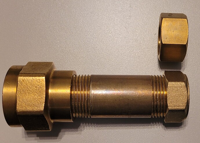

With my new Rotary Tool, I carved out the the bottom of the pill for the driver.
Here’s a before picture:

The tailcap I had was NPT threaded which is tapered so it didn’t screw on far enough.
I found a BSP threaded cap on AE and figured it was worth a look.
It works great because it’s not a tapered thread.
In my opinion it doesn’t look as good but I have to go with function over form on this one.
Picture of the light with the original tailcap:
Picture of the light with the new tailcap:
I needed the tailcap to screw all the way on because the battery tube is 76.5mm long and with the original tailcap the battery wouldn’t contact the springs:
