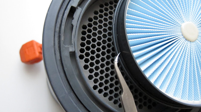

Hi Vas, I think the filters are working okay (comparing to a set of new ones), just the seals are not 100% because the fine dust deposits at key points. Maybe this is partly what you pay more for in addition to motor etc.
Additionally, with the tree pollen lately it is cumulative. ;_;
Here there is a rubber ring around the post motor filter:
I thought maybe some of that rubber sheet could go around here if not a large size o-ring.
And here is the outflow from the dust chamber which butts against the body where the motor is housed. There is a rubber seal on the body but I think it could be improved further by adding a seal to this side:
Thanks islisis. I don’t have any of this, but I already have silicone grease (using Jetbeam!).

You will not believe this!! I started vacuuming today and it’s incredible what difference the silicone grease has made. I am struggling with the floor attachment. The suction is stronger than it was new! :open_mouth: It also doesn’t seem to sound as noisy, which might be also due to the seals.
