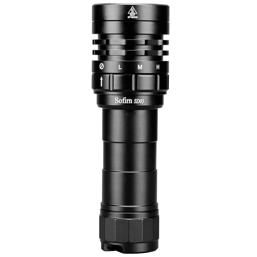

In either case, it may be useful to have a raised line on both the ring and the light body that aligns when the light is off, to help with tactile operation. Kind of like the little bumps on the J and F keys. Just an idea that would be cool for flashaholics and make no difference either way for someone who doesn’t care.
Hmmm…
Maybe Sofirn doesn’t have to do a lot of designing:
How about that?
Sleek, smooth and yet that ‘bone shape’, but maybe a bit slippery and too round…
>> Oh, by the way, it’s important that the output increases logarithmically. <<
This i.m.o. still looks like the most natural interface, ergonomically speaking:
The travel of these sliders is usually very short though, probably for technical reasons or to keep it simple and cheap to produce.
But the shape is good too, but more ‘manly’ than the previous one.
Not sure about the blue stuff, but this body color also looks nice.
Add a clip and it won’t roll off the table.
