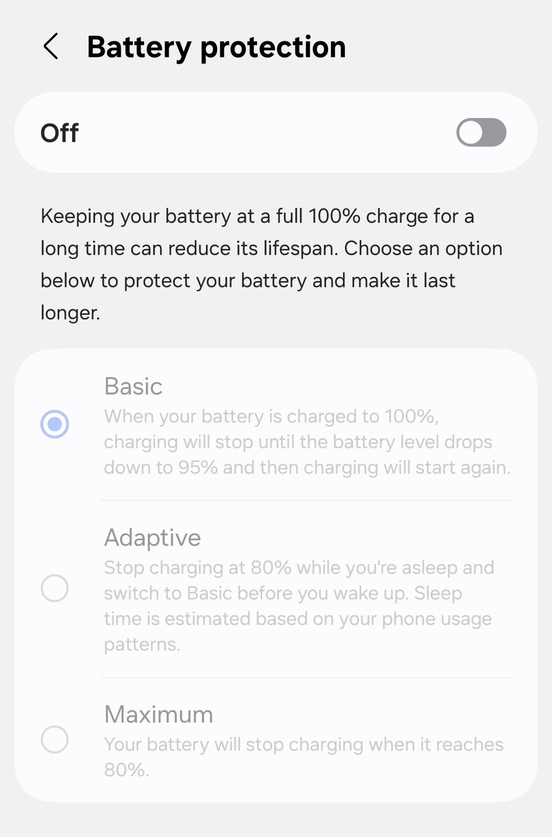

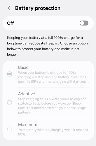

And my Samsung phone has these settings:
Yeah. Modern Samsung devices have this, my 2019 tablet did not, 2022 tablet has it.
