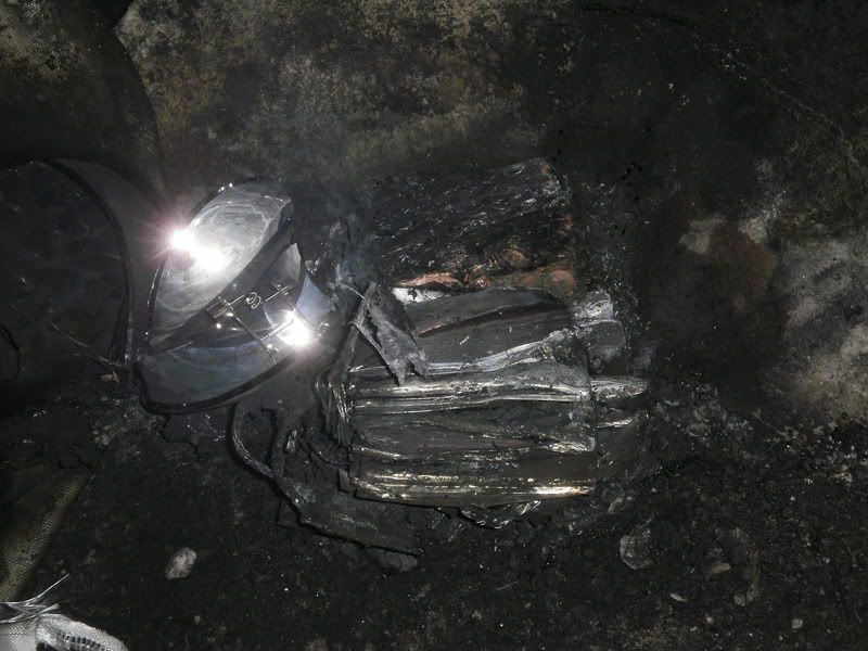

For non hard cased LiPo/Li-Ion batteries there is, any RAPID swelling of the batteries during charging or discharging can be a sign of imminent failure.
My biggest mod light was powered by an 8s2p LiPo battery pack, 10Ah and 33 volts, running 1150 Watts into a 1000W sealed beam filament lamp, producing around 28,000 Lumens. Lamp life expectancy was only 10 hours when overdriven.
