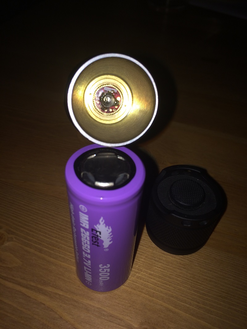

my Z1 is now running with the LED4Power LD-1 5A Driver and an Efest Purple 26650. Short, strong, good runtime
Measured at 212 KLux@1m/Kcd.
Greetings
Kenjii

That looks very neat, Kenjii.
