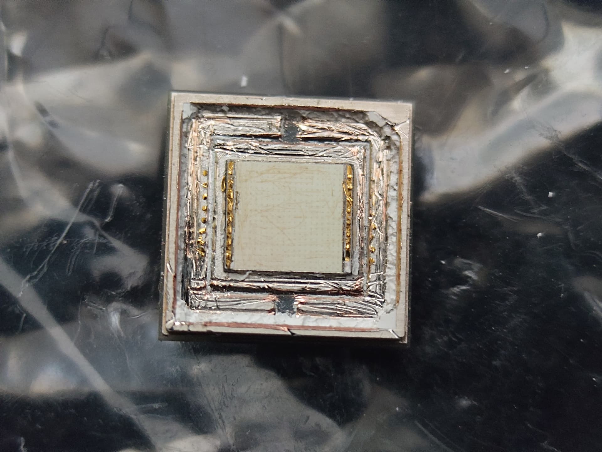

Nice LED but mine was finally DOA or I killed it somehow. No one will ever know because I didn’t checked it before reflowing…
