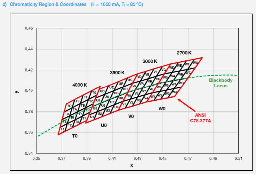

That’s what I feared with the large quantity available, they have multiple bins and I doubt they’ll let you choose from one reel with an order of a few pieces.
Edit : There is actually no detail on the chromacity bins except for 5000K (R3, R4, which are bad)
Re edit : ah no, ā€Mā€ means 3-step MacAdam, so 3000, 3500 and 4000 are all 3-step.
A few interesting pieces of info here but ultimately not what I hoped.
1) there is a different, lower, voltage bin (D2) in that one LED.
2) various brightness bins in the same CCT
3) ā€œTMā€ ā€œVMā€ ā€œUMā€ not helpful in determining where LED might end up on BBL unless I misunderstand their specs.

I PM`D Simon at Convoy, and this is the current LH351D 5000k bin SPHWHTL3DA0GF4RTR6 F2R1T2. Does anyone know what the bbl or duv is of this bin?
In the datasheet page 10 , R1 should be similar to R2 but slightly higher CCT.
Edit : it’s one subrank flux bin higher (T2 vs S2), that can mean a worse tint sometimes (green being more efficient).
