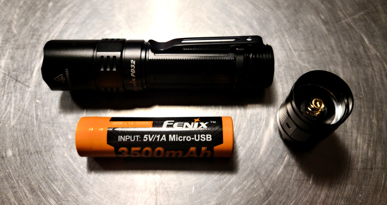

Also my battery is 5.2mm shorter than a Fenix battery. Maybe ill get some magnet spacers.
Just got one of the Fenix micro-usb batteries. With this it is no longer possible to shake or tap it and make it cut out.

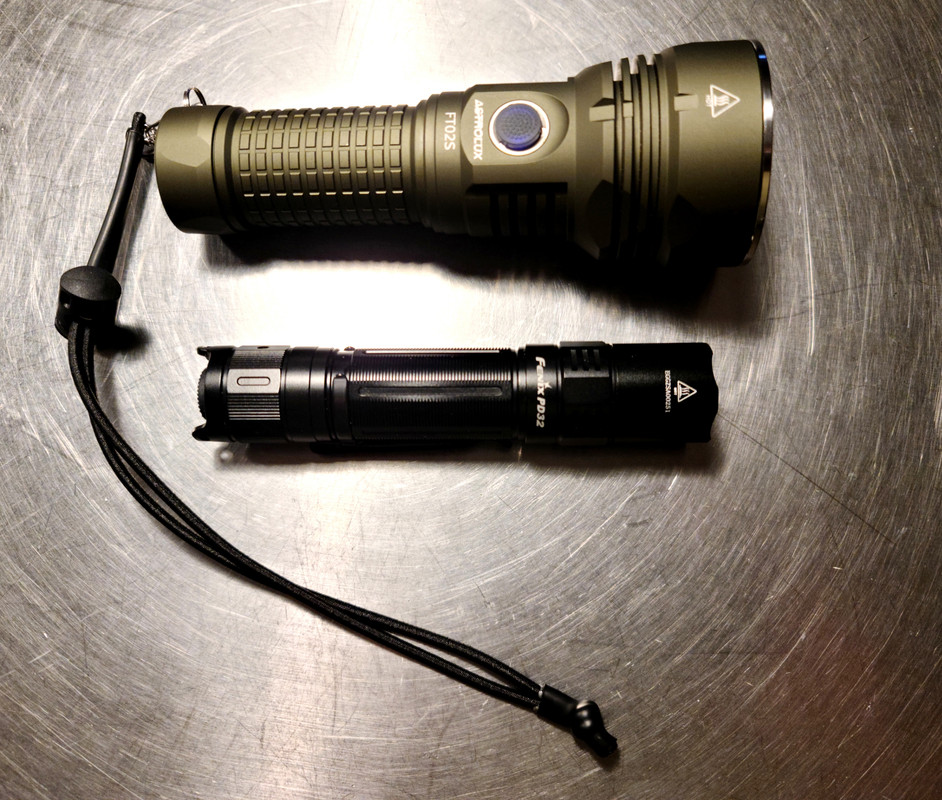

I am very pleased with my new PD32 V2. I am using this light daily in my early morning and after dark dog walks. I carry an Atrolux FT02S for flood and PD32 V2 for throw. The performance of the PD32 V2 is exceptional all around and I am astounded by the flawless beam profile and the extreme distance of throw from such a compact light.
With a bit of fiddling the UI is easily mastered and quite sensible.
I am using a Fenix ARBL18 High-Capacity 18650 Battery - 3500mAh micro rechargeable battery which works perfectly.
I highly recommend this little light for your EDC needs.
