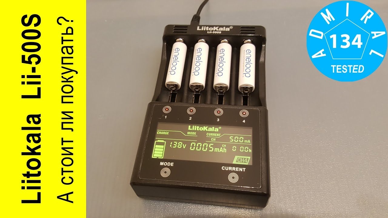

Conclusions from this Russian-language review:
Negative:
1.18650 charges up to 4.25V!!!
2. Removed charge current 300mA
3. Removed the measurement of internal resistance
4. The screen after 15s goes into energy-saving mode and there is no information visible on it, you need to press the buttons to light up the screen.
Positive:
1.21700 support
2.2A charging current for 2 cells

- The overall user consciousness in these matters is lacking. The high charging voltage is probably partly motivated to show “correctly blown up” figures in the capacity tests. Even if not for everyone, take a peek here: DIY: Generic way to lower voltage termination on li-ion chargers.
- ¯\_(ツ)_/¯ (I also can't say I like it).
- The original Lii-500's implementation was botchy. I still prefer to have it as it lets me know if there is something wrong in the rail or cell contacts (rust, debris, etc.), yet I know what is going on and don't complain. Other users just complain and shite happens.
Like putting your canary housepet on a diet halving his seeds to save money. I really wish for they to stop with this endemic electronic bull$#%&@. Really. :-|
I live with it but I hate my multimeter auto-power off feature.

Why is that a negative?
The channel LED color will show charging (red) or finished (green).
The screen doesn’t need to stay on all the time. Only when you put in a battery or when you need to check progress. You don’t sit down in front of your washing machine for 2 hours to see what’s going on either. Or do you?
Mishanchik
(Mishanchik)
51
In Lii-500 at any time it was possible to see indications on the display without pressing buttons. In all chargers Miboxer is done in the same way - information is visible at any time of the charge, only the screen backlight goes out.
I love passing by to look at the charge process. Who doesn’t need all this, he buys for $ 2 a charger with two bulbs - red and green.
