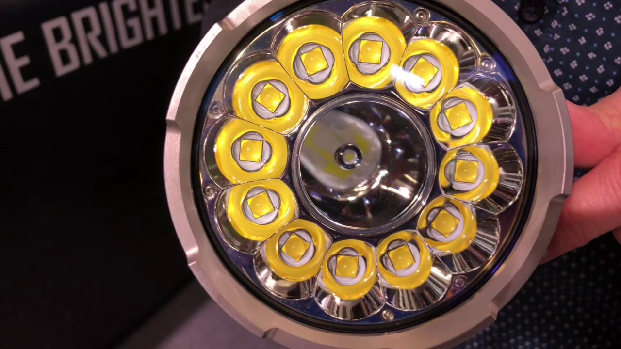

Wow, the X70 is rated at 40,000 lumen. Looks like 3 small fans.

I have to admit, it's an impressive looking light. German guy in the video says the three fans are waterproof, and that the fans would not work if submerged in water but that there shouldn't be any damage if that happens. I like the shoulder strap. He also showed the paper that read 30 minute run time, but I wonder if that means 30 minutes at 40,000 lumens or not. Not clear enough yet.
Sustained 40k lumens doesn’t sound possible, does it? The PowerTac 10k seems to cycle it’s single fan. So if the X70 has an efficient heatsink design with each fan cooling 1/3 of the heatsink area, the fans run continuously and power output drops with battery voltage, then maybe it is possible.
40k lumen for 30 minutes is quite a record. Even if output starts to slowly decline. I have no idea what driver design they might be using.
40,000 ÷ 12 = 3,333 lumen per emitter. That’s roughly 3.5A 4.5A per emitter. 42 54 amps at the 6 volt level or 21 27 amps at the 12 volt level.
21 27 amps at 13 to 14 actual volts would be 273 to 294 351 to 378 watts.
As far as the batteries, it’s using 8 x 18650. If the cells were 4S2P (like the Imalent DX80) that would require at least 10.5A 13.5A per cell. Good cells like 30Q should handle that amperage and temperature it seems (internal battery temp due to the heavy discharge, not heat from the head).
So maybe it is possible. I was not expecting 3 fans. That could be the key to maintaining the high output. Even if your down to 30k lumen when the LVP kicks in at 30 minutes it’s still a remarkable feat.
It really doesn't sound possible. Perhaps that is why the sheet the guy displayed on the video was very vague with no real details. It has to be 30 minutes with a step down I would think, but if it was 40k lumens at 10 minutes and 20 minutes at 20k, even that would still be a huge break through. It would make the Imalent DX80 already seem obsolete by a long shot. You can see they put a lot of thought into the X70. I noticed the reflector is screwed down nicely and the battery charge port is threaded with an o-ring and end cap. Much better than a rubber flap.

Just an update. Acebeam has announced the list price on their X70. It is $750.
I was asked about the triple fan power consumption of the X70 in another thread, so I figured I’d post it here, too.
No one actually knows the size of the fans in the X70, so judging by the video I guess they are about 40mm. The typical 40mm fan uses about 1.2 Watts of power, so three of them would be 3.6 Watts. Compare that to the 350+ watts the emitters are drawing on Turbo and the fans are only using about 1% which is not significant at all. I’d say it’s negligible.
