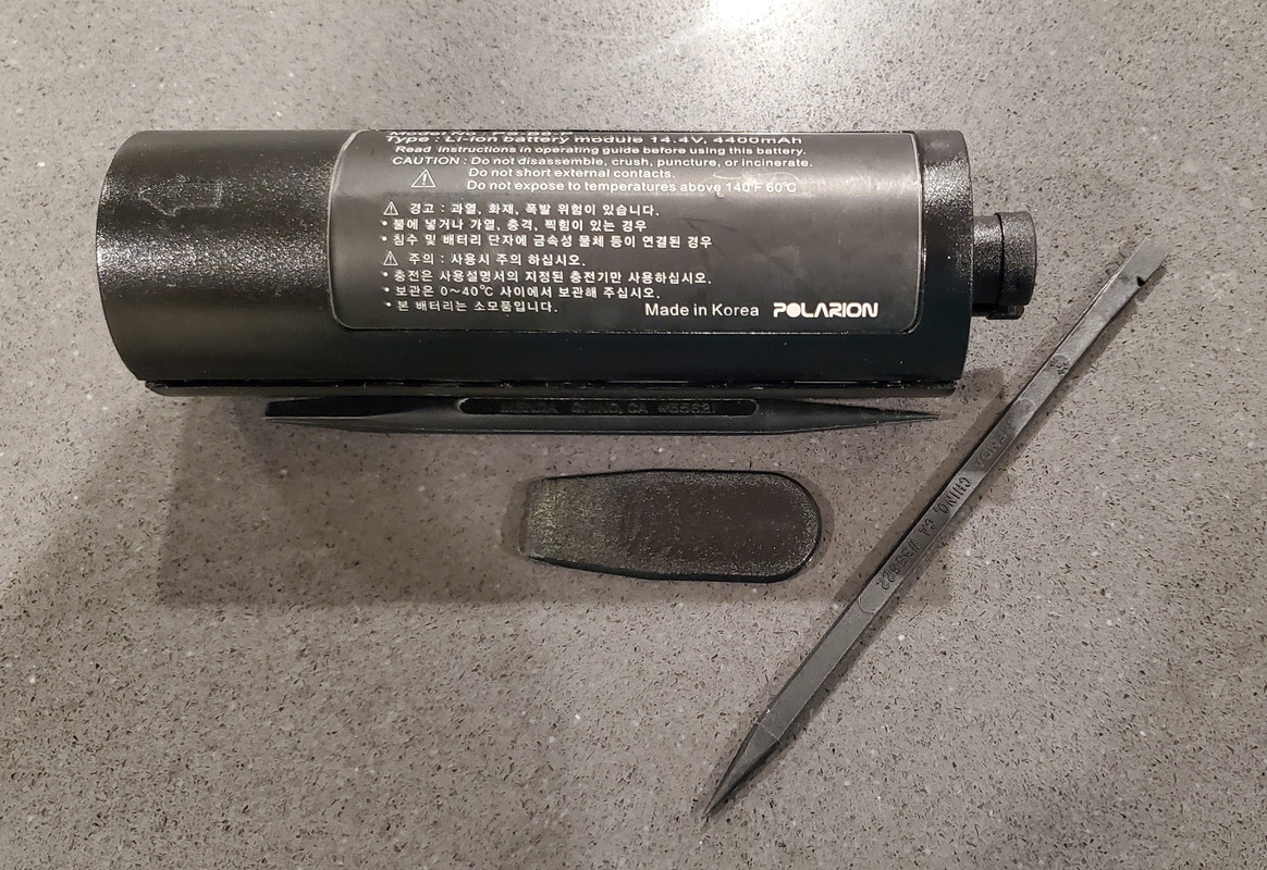

Here is the next pack rebuild…An older Polarion 4S2P pack…
Will likely go with either the Moli M35A or the upcoming Moli P30A (for a potentially larger safety margin)
