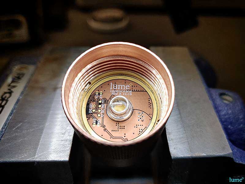

Lume1-FW3X: Constant Current Buck-Boost & FET Driver with Anduril1/2 + RGB Aux

I see your point treellama and Agro... the reason for this choice was due to the lack of cheap common K RGB LEDs on non-aliexpress sources (I had ordered some previously on Aliexpress but it's been a few weeks and they haven't arrived yet), so I decided to go with individual LEDs with the benefit of more fun colours (which I already had on hand). In addition, the MCU VCC voltage is 2.5V for this board so we should not use common A LEDs, not to mention, we also want to take advantage of LED dimming in Anduril (which uses the internal 10k pullup), common cathode LEDs need to be used as opposed to common anode. Changing the design to fit RGB LEDs is very straightforward.
Is this something that people would prefer over individual LEDs? If so, I'll release both boards, one with individual LEDs and one with RGB LEDs so anyone can build their own :). They will provide a different look, which I guess is a matter of preference. In order to reduce standby current, Anduril does not PWM the AUX LEDs though, so just something to keep in mind (otherwise we can do a lot of nice effects like blendy RGB modes). Finally, a thing to note about the lowish 2.5V drive voltage - this does have some limitation if you want really bright AUX LEDs - this is just about possible with very small series resistors for the blue LED, but will affect overall look when using the 'dim mode'. This depends on the specific LED used though, and their associated V_fwd. Otherwise, it works ok.

Really great design loneoceans.
3Amps for regulated mode is perfect in my opinion. It is usually enough to keep around 1000 lumen beam.
I saw there was already question for schematics, but I think I missed answer. Anyway I think that if you would like to see this design in more lights it could be good idea to share schematic together with component list as some of us here are able to adapt it to different pcb layouts for other flashlights.

Has anyone had any luck finding a spring for the driver? The closest one I found was at Kaidomain and required cutting down.
Maybe Bluesword short BeCu springs might work
They are too long and will be too stiff if cut down.

Does this mean you have one of these, or are making one? Wondering if "loneoceans" is far enough along to release it in some form? I'm definitely interested buying a couple, either parts or assembled.

Iā€™m not making on of these drivers although I did build a GXB172 today. He was looking for a driver spring and asked us if we knew where to find one. It would be a waste of his time that could be better spent proofing out the driver. Itā€™s no fun for him and just slows things down, someone here must know were to find one.

Looks like the FW3A springā€¦
Try Victor at Lumintop abbie@lumintop.com
I conversed with him last week, he answers to this e-mail.
