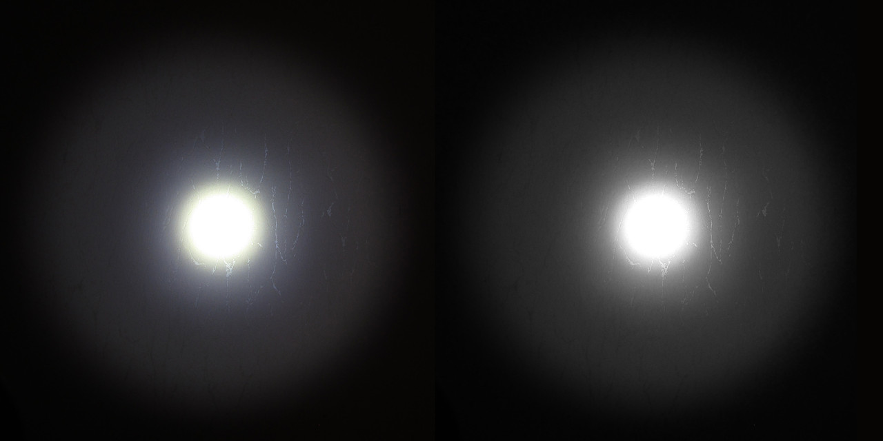

I can see from the two comparison examples that the SMO reflector choices or reflector & emitter pairings were unmatched at best and looking anything but correct. In these two cases, the OP counterparts, if at all of the same geometry, are much more desirable by comparison. Not sure if the pictures are biased in any way or the other, but I cannot see much difference in actual smoothness in these beams as well, SMO VS OP.
Those were both examples of side-by-side beam shots showing cases where the only thing changed was the surface texture of the reflector. Each pair is the same light, same LED, same camera and settings, same reflector shape overall… but one had a smooth surface while the other had an orange peel surface. And I made sure to only use examples where the beam was well-focused and had no major artifacts.
The idea was to isolate changes to only one variable, to better demonstrate what that variable does.
The pictures show a pretty decent representation of what I’ve seen personally when swapping reflectors in an individual light. Some lights have come with an option of SMO or OP and I got both, though after doing that a couple times I stopped getting the SMO option because I found OP consistently gave me a beam I liked more.
In general, SMO provides a slightly brighter hotspot with slightly more throw, and sharper edges between parts of the beam. OP provides a slightly dimmer hotspot with slightly less throw, and different parts of the beam are more blended together.
Outside of the hotspot and corona area, there is no difference between the two. The reflector texture only affects those parts of the beam.
Those were both examples of side-by-side beam shots showing cases where the only thing changed was the surface texture of the reflector. Each pair is the same light, same LED, same camera and settings, same reflector shape overall… but one had a smooth surface while the other had an orange peel surface. And I made sure to only use examples where the beam was well-focused and had no major artifacts. The idea was to isolate changes to only one variable, to better demonstrate what that variable does. The pictures show a pretty decent representation of what I’ve seen personally when swapping reflectors in an individual light. Some lights have come with an option of SMO or OP and I got both, though after doing that a couple times I stopped getting the SMO option because I found OP consistently gave me a beam I liked more. In general, SMO provides a slightly brighter hotspot with slightly more throw, and sharper edges between parts of the beam. OP provides a slightly dimmer hotspot with slightly less throw, and different parts of the beam are more blended together. Outside of the hotspot and corona area, there is no difference between the two. The reflector texture only affects those parts of the beam.
As per my initial impression, that just looks like an unfortunate pairing of reflector and emitter, or, simply a poor reflector design.
