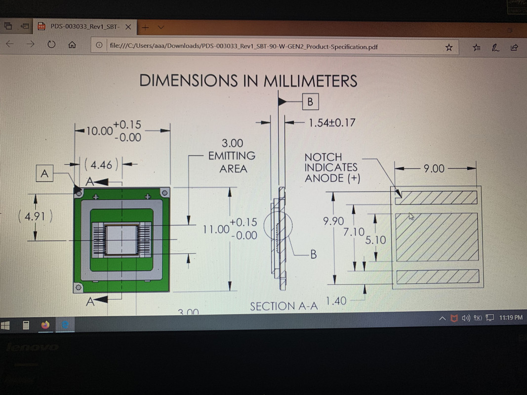

The higher lumens ouptut indicates, that the lens probably doesn't touch the phosphor. This is different from de-doming.

Correct it dose not. Now factor in the tolerances, emitting area to top of glass has a larger tolerance then the Datum B to top of glass has? So it’s the phosphorous pad that varies also.

Kawiboy, What does that black ring that sort of looks like felt in the picture around the base of the SBT90.2 do for you? Remove beam artifacts or insulate the reflector? Curious. Awesome builds. Thanks
That is the old SBT90 centering ring which is a 10mmx10mm opening I had to make it 10mmx11mm for the SBT90.2…
