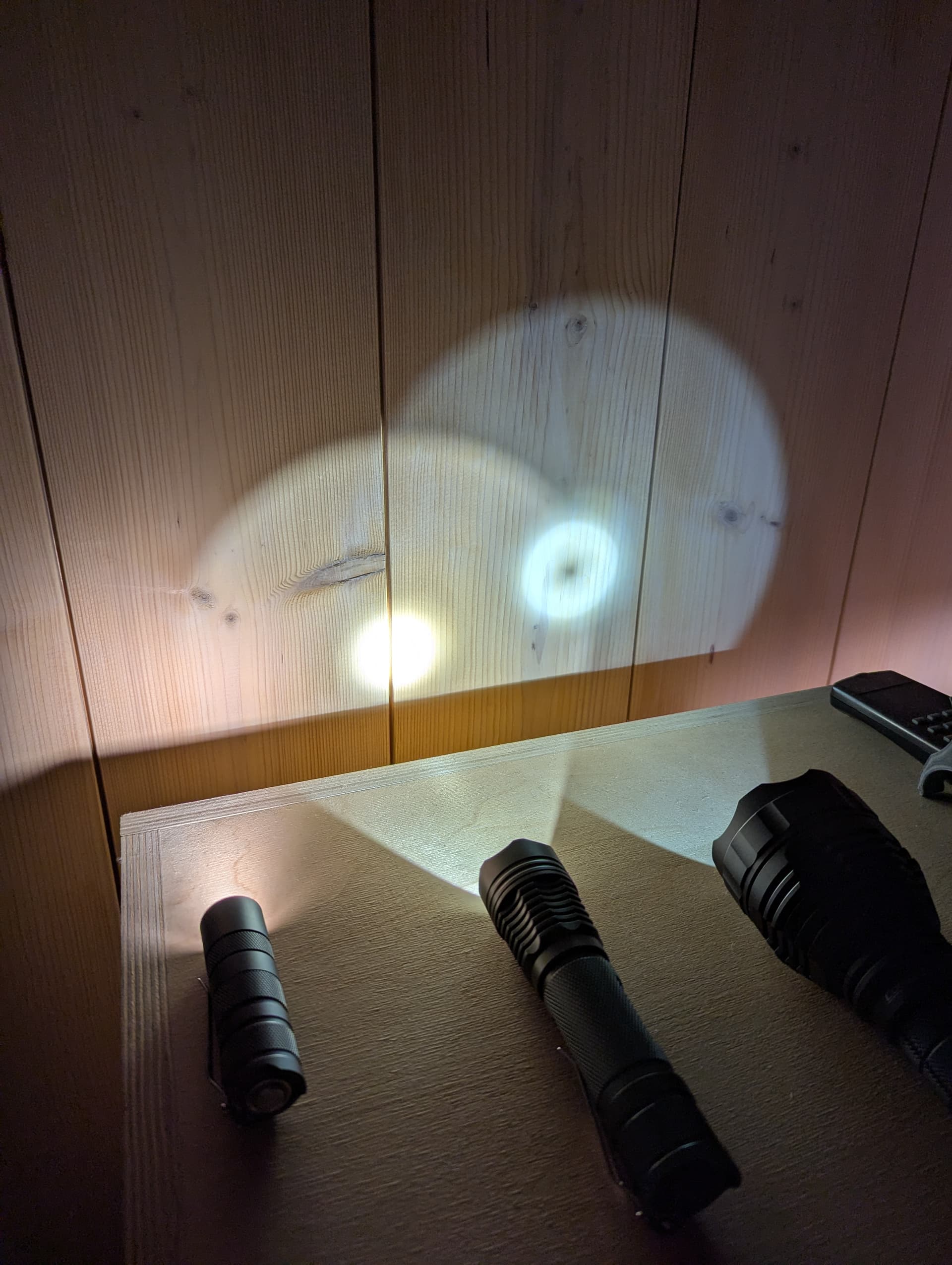

Keep us updated, I just tossed my SFT-90 in my L21B with a 6V8A driver because I’m impatient waiting for a FET driver, and it worked! Single mode, unsurprisingly. I measured 18.8A, 4000 out-the-front lumens on the TKLamp. That’s with a P45B. Quite ringy, at least with the KR1 centering ring I used.
No proper beamshots yet, just some phone cam pic.

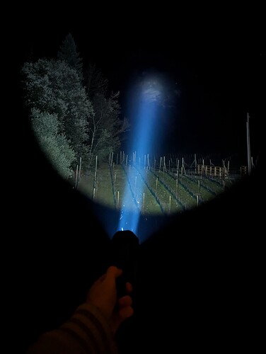

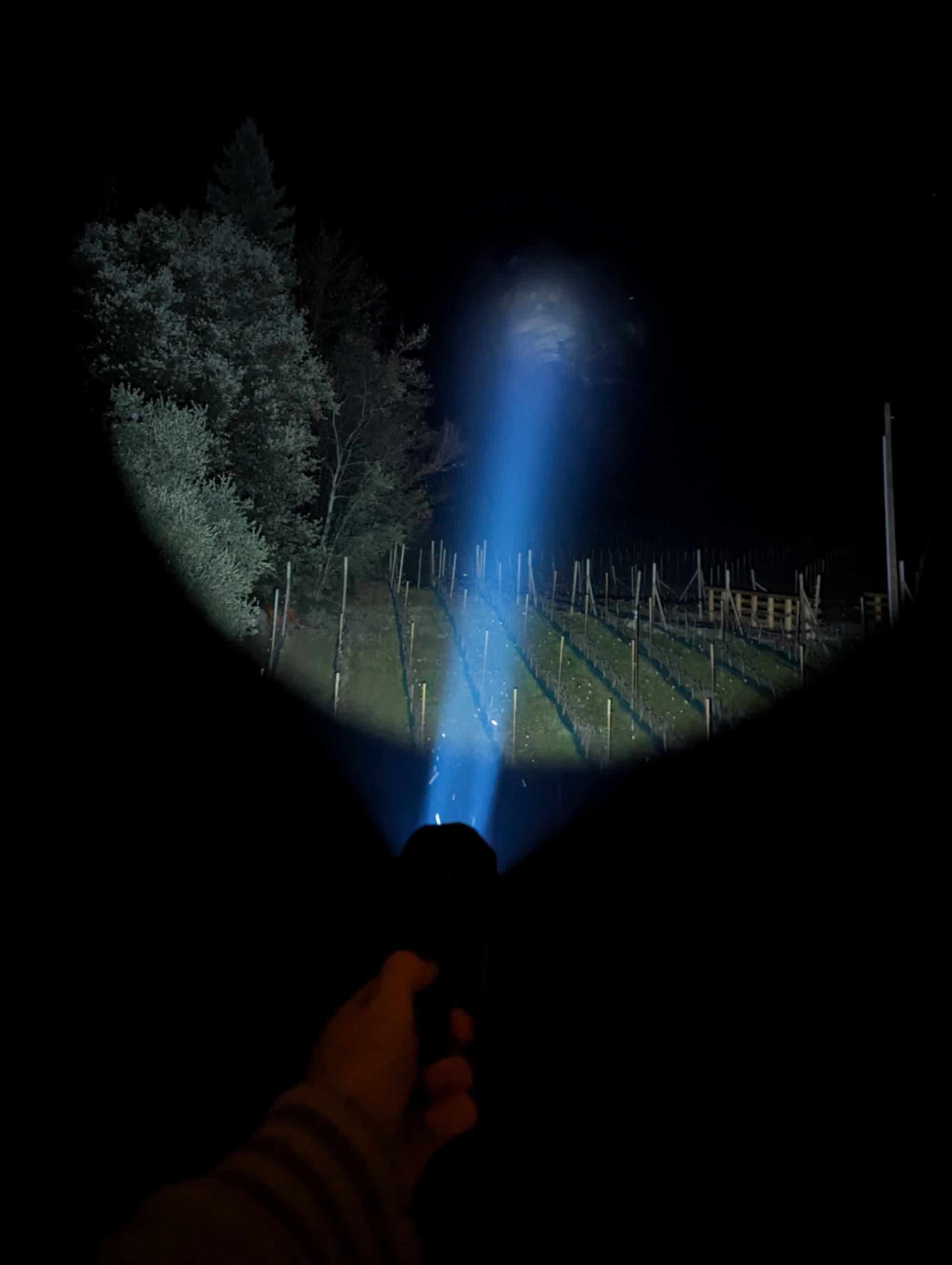

The SFT-90 is fun and works decently well in a T6 with FET driver ^^

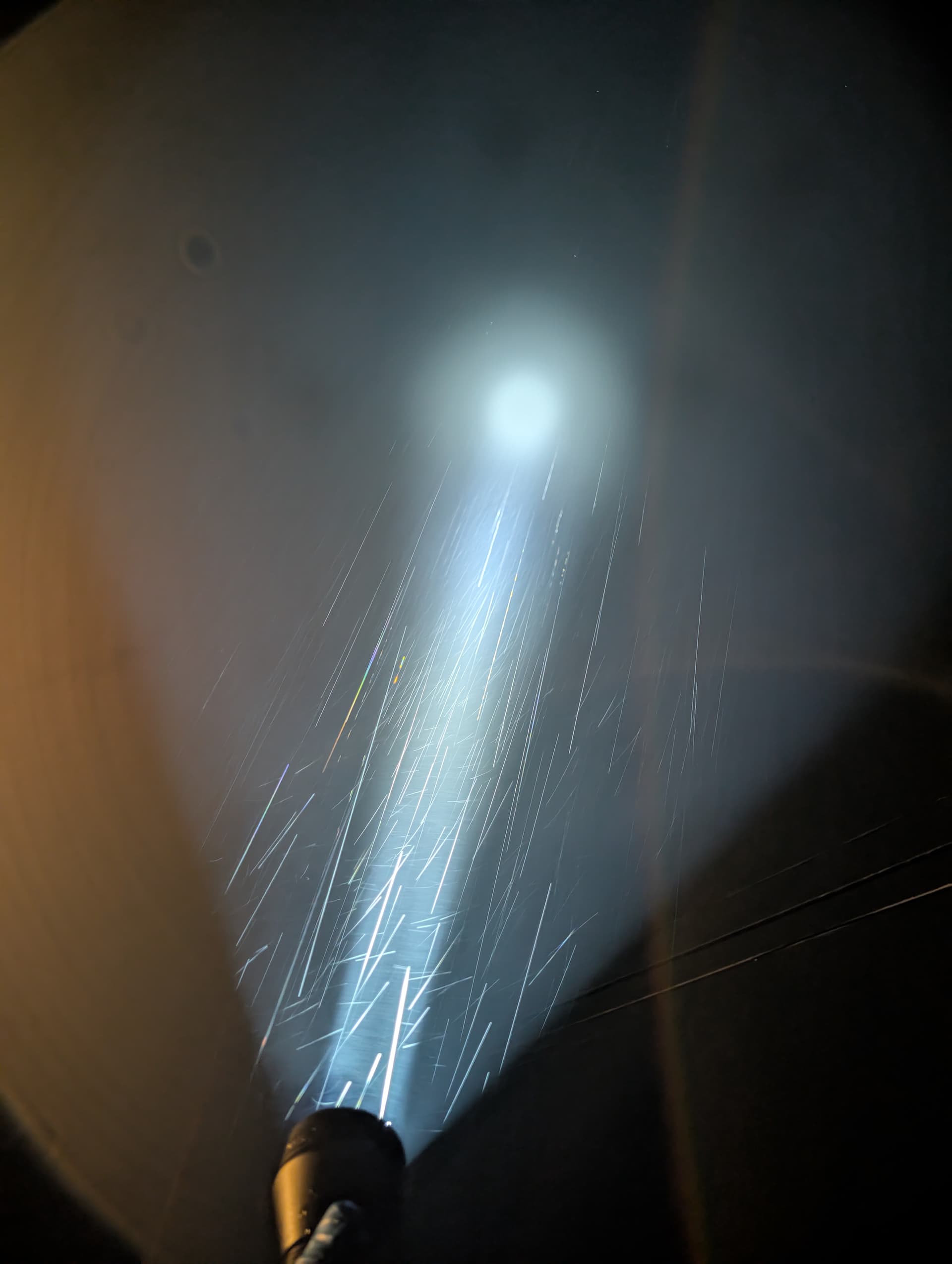

With FET driver, reading about 22A at the tailcap and 4100lm. Looks like that last 3 amps is mostly heat
