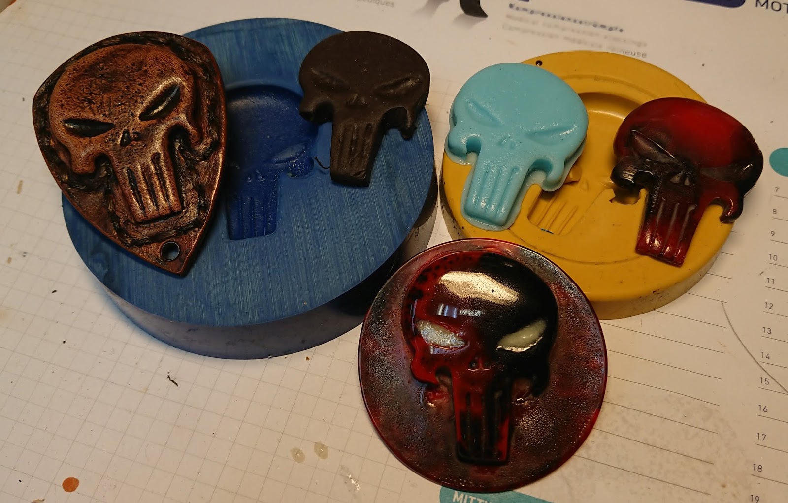

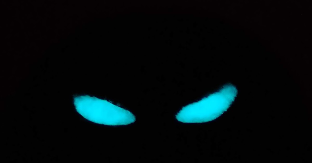

My last glowing project was this:
Nice, what is it made of? Are the eyes resin with glowing powder mixed in?
Ok, the process was quite long.
First a colleague who wanted a leather key fob made a sample (not on the pics, but the same compound material as the blue form).
From that sample I made the yellow silicone mold which was also used for the epoxy resin head.
I mixed 2 portions of epoxy with red respectively red epoxy paint and poured them into the mold, the first try looked like this:
More details:
Cheers!
Opps, I haven’t realized that the first try is on the other picture already, hope you don’t mind ![]()
Cool stuff and well-made! Thanks for the explanation. ![]()
You’re very welcome ![]()
