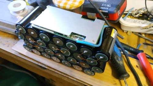

Photos from a french fellow review in this sale ad: https://www.aliexpress.com/item/32811943155.html
Wow! :facepalm: He built an e-bike battery pack where he is using a thin wire to carry all the current from each battery stage (up to 30A or more). Creepy! Hope he is fine, really. I would have used ≈5x AWG20 wires or 5x (2 × 0.25) mm² solder wick patches for that same requirement, better safe than sorry.
