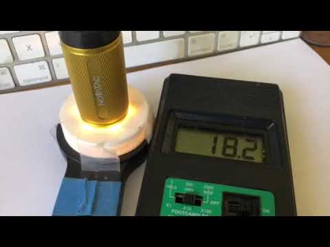

there is a vitamin jar lid over the sensor. I calibrated it by adding a couple pieces of printer paper and kleenex, until my meter read, what I though the output of the light I put on it was supposed to be, per manufacturer.
at the time I use a light called a Lumintop AAA Copper Tool, that had a 0.8 lumen low, and I calibrated to that.
later I got an HDS, which is supposedly calibrated to 200 lumens. My meter said 210 lumens, so I added a bit more tissue paper, and viola, bobs your uncle
example of using the light meter to check for output fluctuations (regulation):
