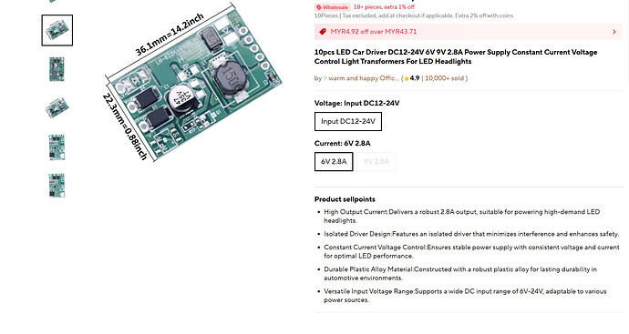

How about this stuff? It says “Driver constant current voltage”(?) ^V 2.8A for 2 sft40 in series, sounds good(??)
This is the highest amperage output driver I have been able to find with a suitable input voltage without scouring the web. You’d need 1 per LED though, and it must be heatsinked. It’s potentially viable without that power converter in the circuit, assuming your bikes voltage is fairly free of high voltage spikes.
The SFT40 really comes into its own around the 5A mark, but most drivers with suitable voltage ranges don’t allow for multiple LEDs per driver.
Lack of drivers has really been the limiting factor in my attempts to modify lights. It’s a niche that could probably sell well given how many people have quads, utv’s and other offroad vehicles.
