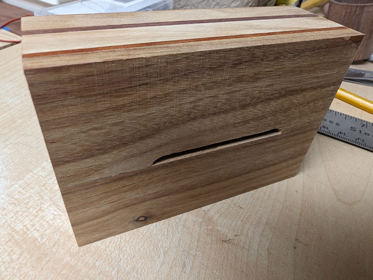

OOOPS!
I had a mishap when routing out some more spaces. Fortunately, I have all my fingers, not even a scratch on me…
I believe this is salvageable. Just extra work…

Ouch! What a pita.
Boy that sucks! I am glad that I am not the only one who often ends up regretting it when I try to make something just a little bit “better”…
Sorry to hear about your routering mistake, only caught up with the progress now. This looks like it could be an awesome build and the copper heatsink is cool! You still have time to turn this around and could be a good chance for 1st place. Fair play mate, really enjoyed reading your thread!
Thank you for including the mishaps. Sometimes it seems like other modders never make mistakes and I am just not that good at this. It is a nice reminder that we are all human, and encouraging to see you moving past the mistake and salvaging things.
It’s why I always liked the “what you broke today” thread

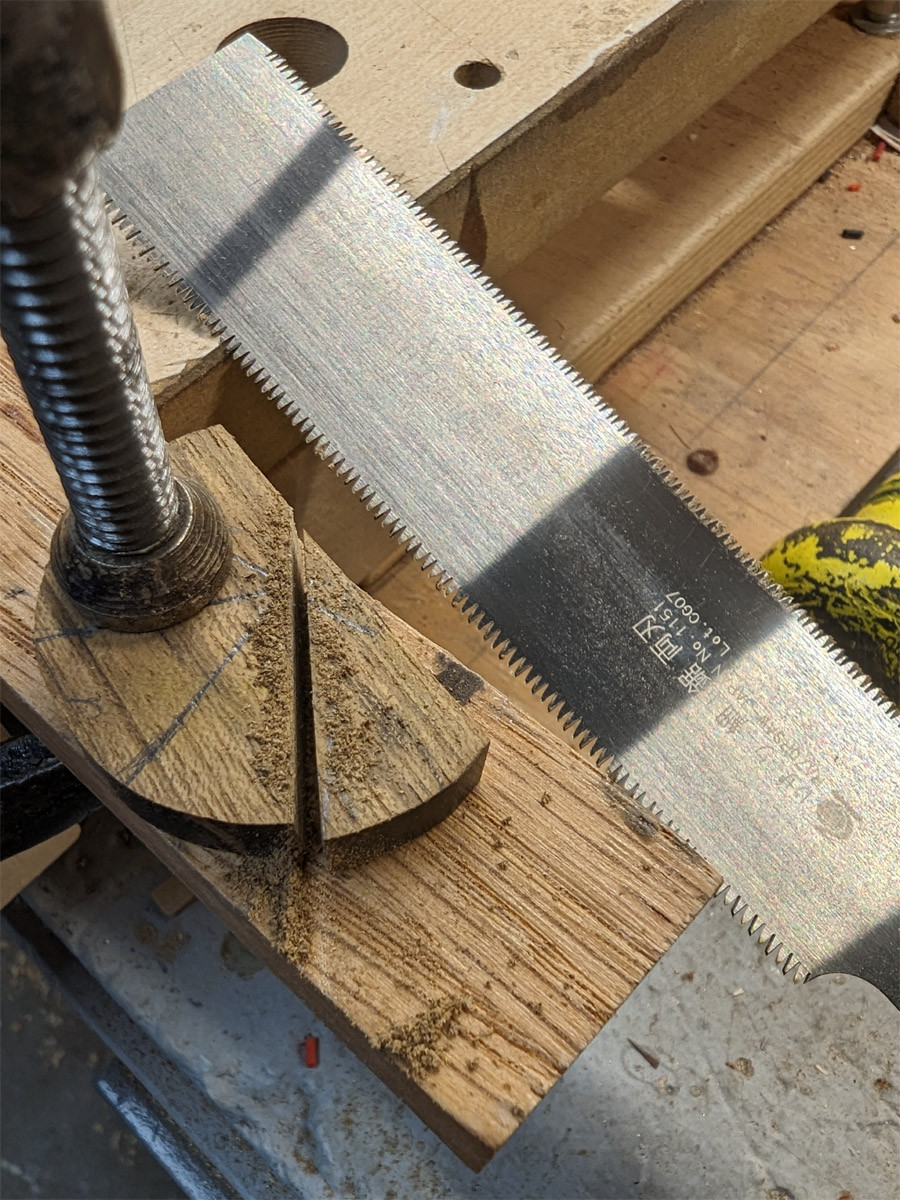

I cut out a space for the 21700 cell.
A Japanese handsaw that I like for fine cuts.

The mishap was caused by operator error, that is me. Operator errors are the cause of a whole range of bad things. I had done most of the other operational things correctly, then made a mistake. It only takes one error to negate all sorts of positive steps. Oh well.
Without getting into an entire chapter in a woodworking course, I’ll try to explain. I had cut a slot in the block and widened it. I wanted the slot to be a little longer. Seemingly a simple enough thing to do.
I was using a router bit with a 1/2" diameter. The slot was to be 13/16" deep. When cutting material out the general rule is that the depth of the cut should be no greater than one-half the diameter of the cutter. I did that making the first slot cut in 4 passes. I used 1/4" increments and then a final 1/16" pass. I reset the fence and made a second series of shallow passes to make the slot wider.
It was then I realized I should have made the slot about 3/8" longer at one end. The bit was raised the 13/16" full depth of cut. I tried to cut that 13/16" depth in one short 3/8" long movement of the workpiece. The cutter bit into that wood face and the work-piece began to chatter, jump. I let go of the wood block and hit the stop paddle. There is no brake on the router so it took several seconds for the bit to stop. The block did jump free of the bit and I caught it. I don’t know if it is instinct or from training, but when the process started to chatter I knew things were going awry and the thought was to keep my fingers clear, not to try and hold the wood block. Trying to hang on to the workpiece can cause your fingers to be sucked into the cutter. That can be messy. That is how people lose fingers. After 62 years of using power tools I still have all mine so I must be doing something right most of the time.
I believe there were 2 methods, either of which would have been better, or safer. One method would have been to lower the bit all the way and make the new passes incrementally, the same method used to make the initial slot. In this case, the other method would have also begun with lowering the bit all the way and then repositioning the workpiece directly over the bit where the new cut was needed. The block then held or clamped in place, the router motor turned on and the bit cranked up 13 turns. There might have been a need to clean up that plunge cut a little with a chisel.
I think this mishap was made more likely to happen by several factors. These woods are moderately dense hardwoods, much harder than common pine. The rotating bit can get a good grab. Perhaps a softwood would have been cleanly cut more readily without the grabbing? Also, the direction of sliding the wood into the cutting edge of the bit meant the bit was cutting into end grain and once again, the bit edges could more readily grab, or hog into the wood.
Anyhow, using power tools does require concentration and thinking. I fell short this time.

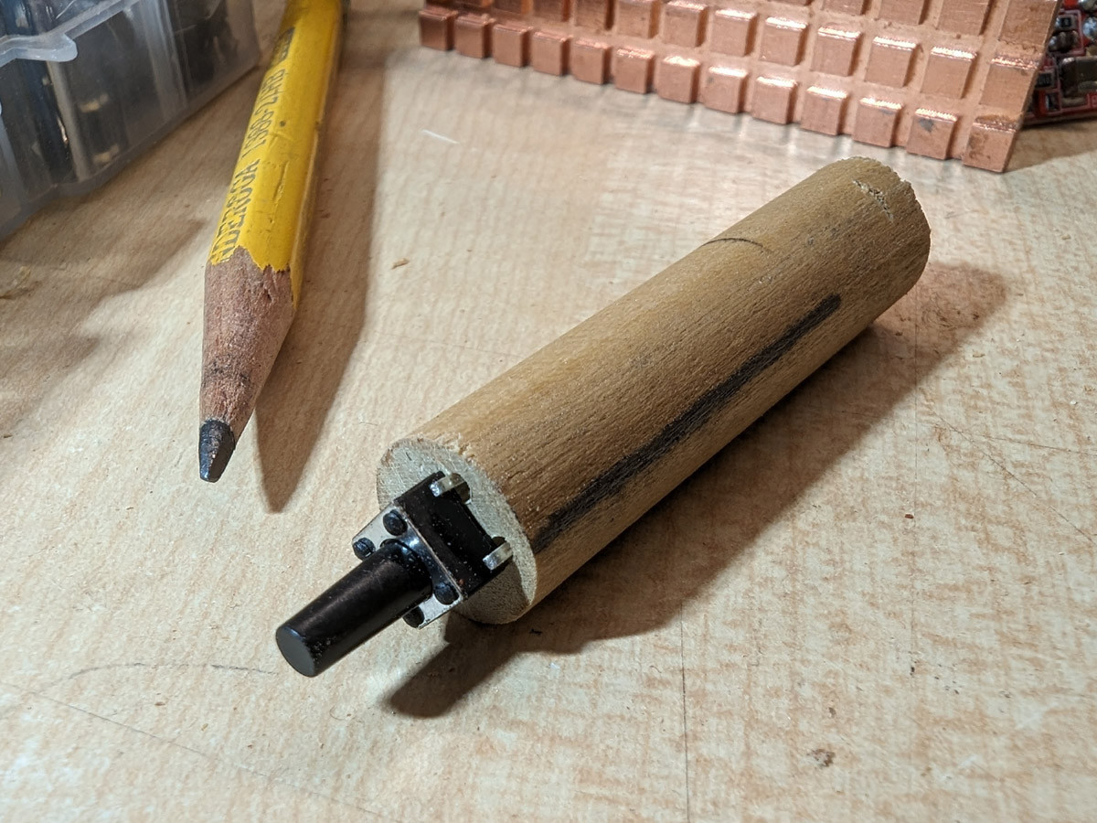

Here’s my switch, a momentary contact (on) switch to go with the driver running Anduril2
firmware. I have a box of these with various lengths of the actuator rod.
I drilled 4 holes in the end of a 7/16" dowel, for the circuit legs of the switch to slip into.
I carved two grooves out of the dowel sides.
Some 26 ga wire was soldered to the switch lugs. The wires will run up the length of the dowel in the grooves.
The dowel, with the switch on the end is inserted into the previously seen 7/16" drilled hole. The switch actuator protrudes from the small hole.
I disassembled the switch and rod and cut the dowel shorter. Pathways for the wires will be cut into the main body block from the switch unit to the driver. A bottom cover plate will retain the switch assembly.

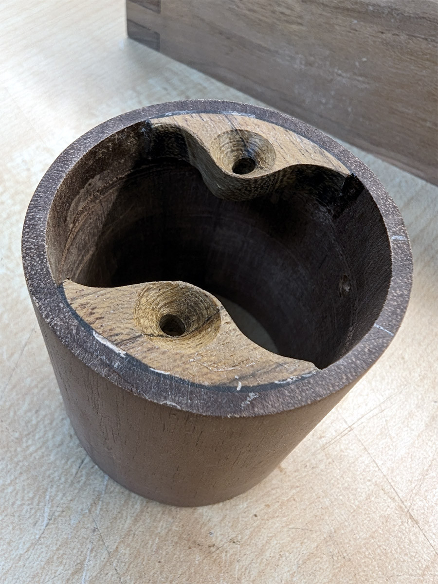

The black anodized led heatsink will be fitted inside the walnut sleeve.
To secure the heatsink in place I made some supports. I cut a scrap piece of 1/4" thick walnut and sanded a circular shape with the curvature needed to fit inside the sleeve. Then cut wedge shapes and trimmed them. I made more than I needed for this, but better to have extras, just in case…
Two of the pieces were CA glued inside the lower edge of the sleeve. The heatsink will rest on them once everything is assembled.

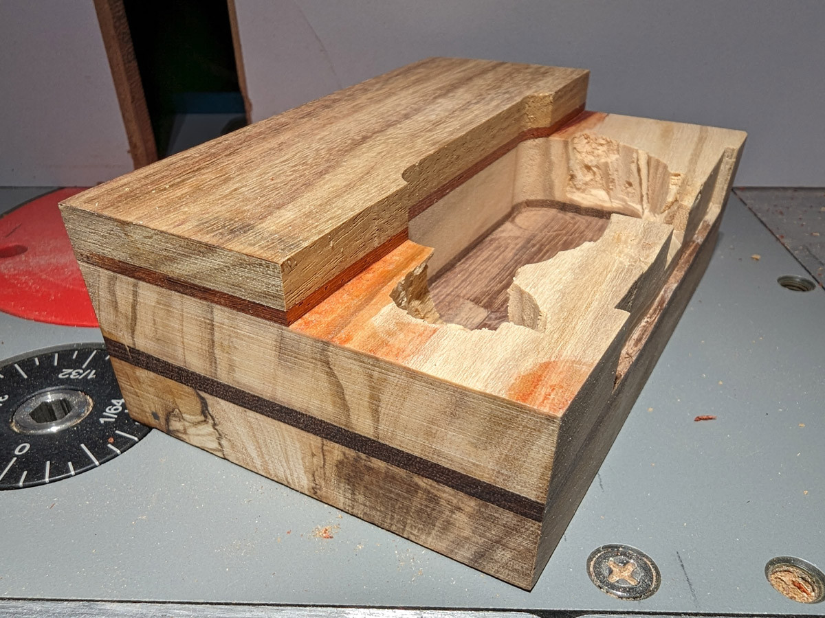

I have planned to drill a hole to carry two- 20 gauge wires through the piece of spalted olivewood which is the vertical board. The board is about 7 inches tall and the hole I intended to drill is lengthwise up the 7-inch distance. The board is 1/2" thick, the hole would be 3/16" in diameter. I ran into an extraordinary amount of drift while attempting a test hole in a cut-off scrap of olivewood. Three times I tried and three times they either split the olivewood or simply ran out the side.
I have drilled such holes parallel with wood grain before. Most of the time they have been successful. Sometimes the direction of the grain or a variation in the density between the growth rings causes difficulty. Compounding this is that I am down to the last pieces of olivewood and the suppliers I have used in the past no longer carry any. I don’t want to mess up my last suitable-sized piece so I have rethought my original plan.
I do have a solution that should work fine. But before I get to that I have experienced another small glitch. The glitch was with the last item of work that I showed above, the cylindrical walnut sleeve that will encase the LED heatsink. I messed up drilling holes in the glued-in ears or tabs. The first hole I drilled was mispositioned. That threw off the placement of the hole in the other tab. So, I ended up grinding those tabs off with a Dremel tool. I made new larger tabs, giving myself more space for error.
Then after drilling holes successfully, I ground or cut the excess material away. Below are 2 photos showing the tabs and the heatsink fitted in the sleeve and retained by two 4-40 machine screws. The MCPCB fits to the heatsink nicely.
Let’s go back to the hiccup with that glitch out of the way. I will not attempt to bore a hole through the olivewood I have started for the vertical board. Instead, I carved a channel out for the wires and will be hiding that with a cover strip.
